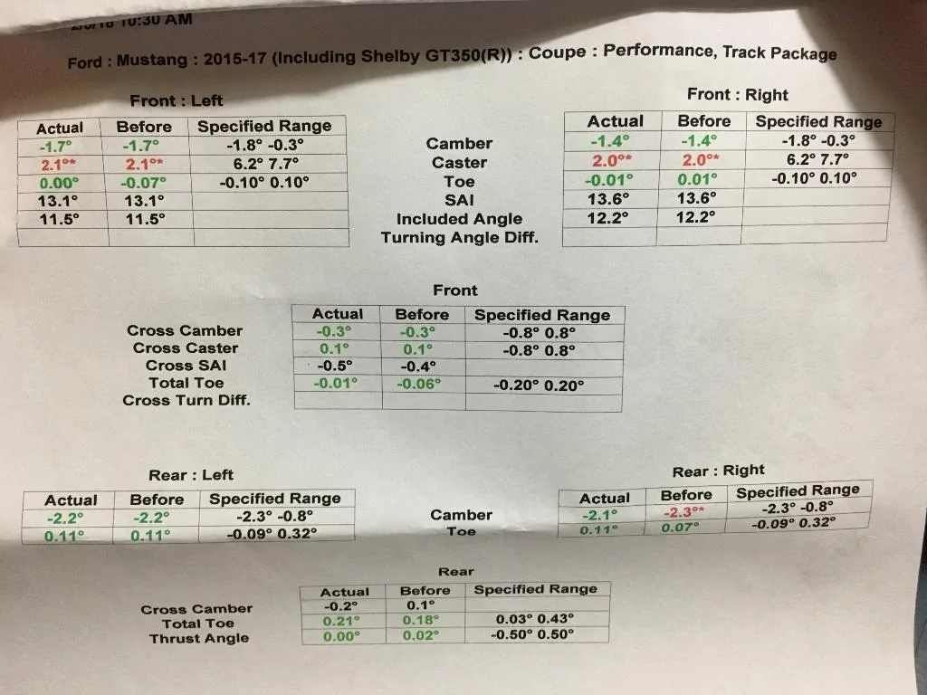

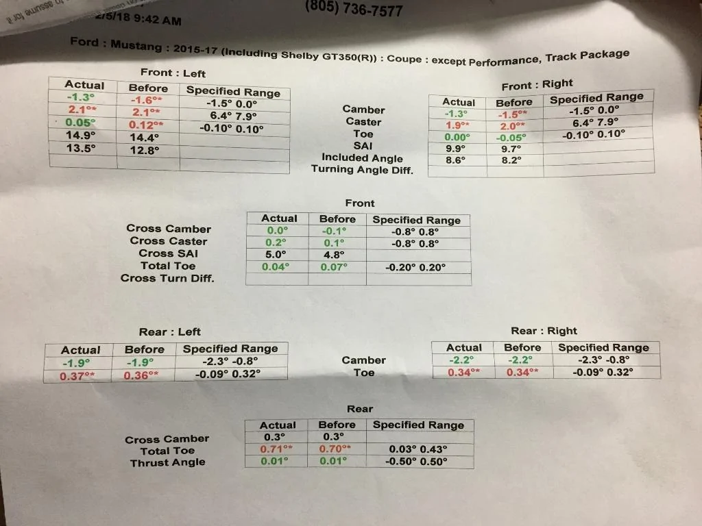

Hey guys. I got an alignment today, but I don't know what I'm looking at on these sheets so experienced input would be great. I asked for the Performance Package specs since I recently had those dampers installed along with BMR springs and Steeda shock mounts. I got 2 sheets, one before and after I guess. Goal is just a spirited daily driver. I've only driven 15ish miles so far and seems fine...anything to be worried about?
