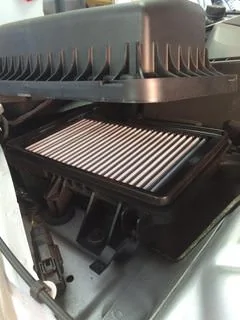

I decided to switch from a K&N filter to this aFe Dry filter because I unfortunately have to drive and park in a very dusty environment.
This filter still has increased flow over the stock filter, plus you can just vacuum it clean:
Here are some pics if you want to get rid of the stock paper filter and swap it over for an aftermarket air filter.
Simply pop off the two clips holding down the lid:
http://i.imgur.com/7FFv2bx.jpg
With a little bit of wiggling, push the lid toward the front of the car to release it from the three tabs, and it lifts up. The sound-tube surprisingly does not get in the way of doing this at all:
http://i.imgur.com/FMFo2W3.jpg
Then slip in the new filter, close up the lid, and you're done:

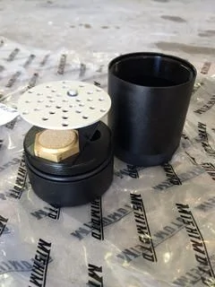

Mishimoto’s Direct-Fit Baffled Oil Catch Can
Date completed: 4/9/16
Link to Michimoto's site
*Click on any picture for a larger image*
There are a lot of oil catch cans on the market for our cars, and they basically do the same thing, but (in my opinion) none have really looked as good as they performed. Until now. I really like the way this kit looks in the car!

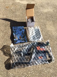

Packaging was excellent. Everything came in perfect condition:
Two ends come pre-connected to the hoses, but the first thing I did was remove the hose clamps and replace them with cable ties. I think the look is so much cleaner, and there is no chance of the hoses pulling off:

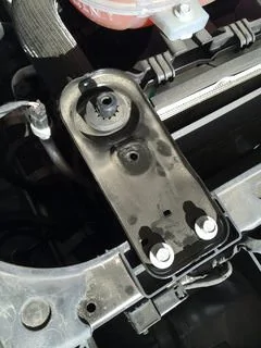

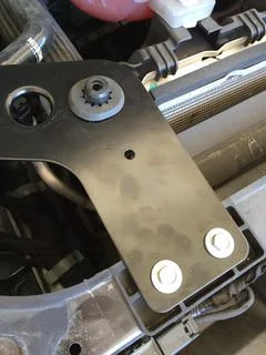

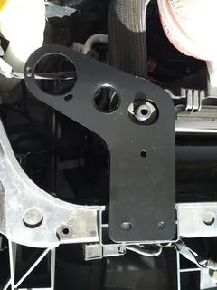

Here is the new bracket lying on top of the old one. That wire seems to be in the way of the catch can... but we'll address that later:
Remove the the two bolts holding down the old bracket (10mm socket) and remove the rubber insert. Insert the rubber insert into the new bracket, and reinstall with the two stock bolts. If you are a torque freak like me, 40 in-lbs works perfectly:

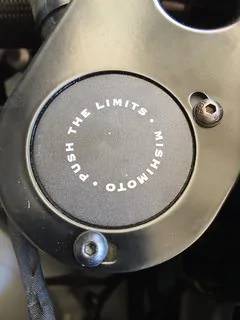

Now install the fittings into the can. These are tapered and plastic going into metal, so I made them hand-tight, and then snugged them down with a 17mm wrench. Nothing too tight:

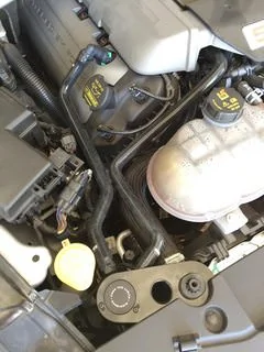

Then using the small screws and washers provided, attach the catch can to the bracket from underneath (2.5mm Allen wrench). I purposely rotated the screws to one side of the slots as you see, as it kept the one fitting away from the windshield wiper fluid filler neck:

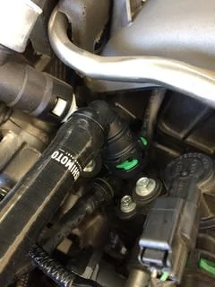

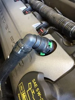

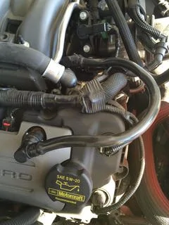

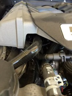

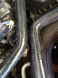

Now snap on the pre-connected fittings to the valve cover and to the intake:

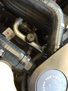

And now attach the other ends of the hoses to the fittings on the catch can. Again I used black cable ties instead of the hose clamps. Once these are pushed on all the way, rotating them just a little bit will change how the hoses lie in the engine bay. Make sure you are happy with how they look before tightening the hose clamps (or cable ties):
By the way, here is how that wire runs. This grey zip tie can be removed and then there is plenty of slack to run it around the catch can and under the fittings:

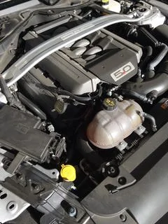

Now you can replace the engine cover (if removed) and the radiator cover, and you're done!
Some final pictures of fit and finish:
Now I think I'll clean my engine bay!! :)
