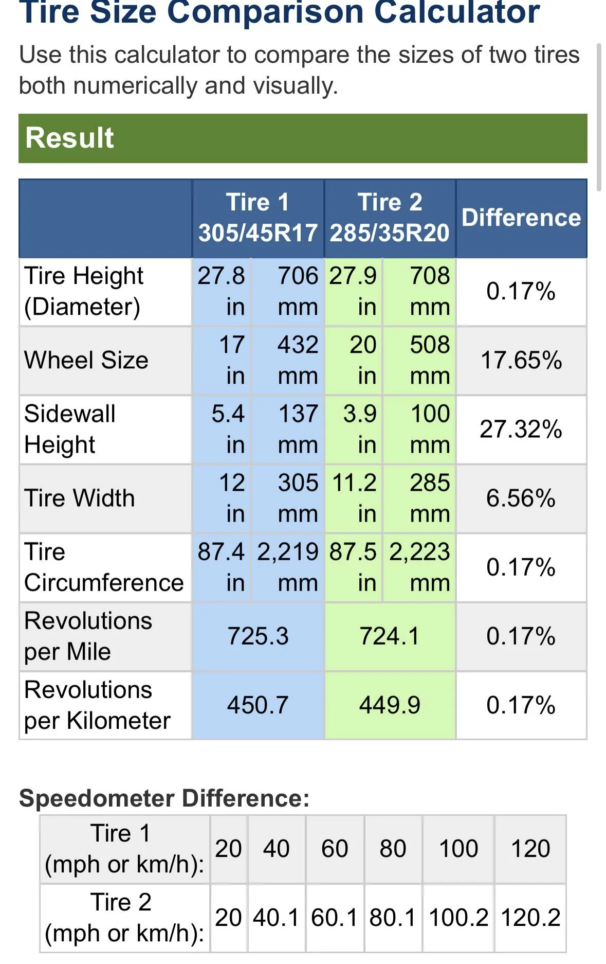

I am looking to get some better traction out back while keeping good esthetics up front. I am considering a new set of Welds that are 17x10 out back and 20x9 up front. Running 305/45/17s and 285/35/20s respectively.
Online calculators show that the diameters are very close. Am I overlooking something obvious here that would make this combo a bad choice?
