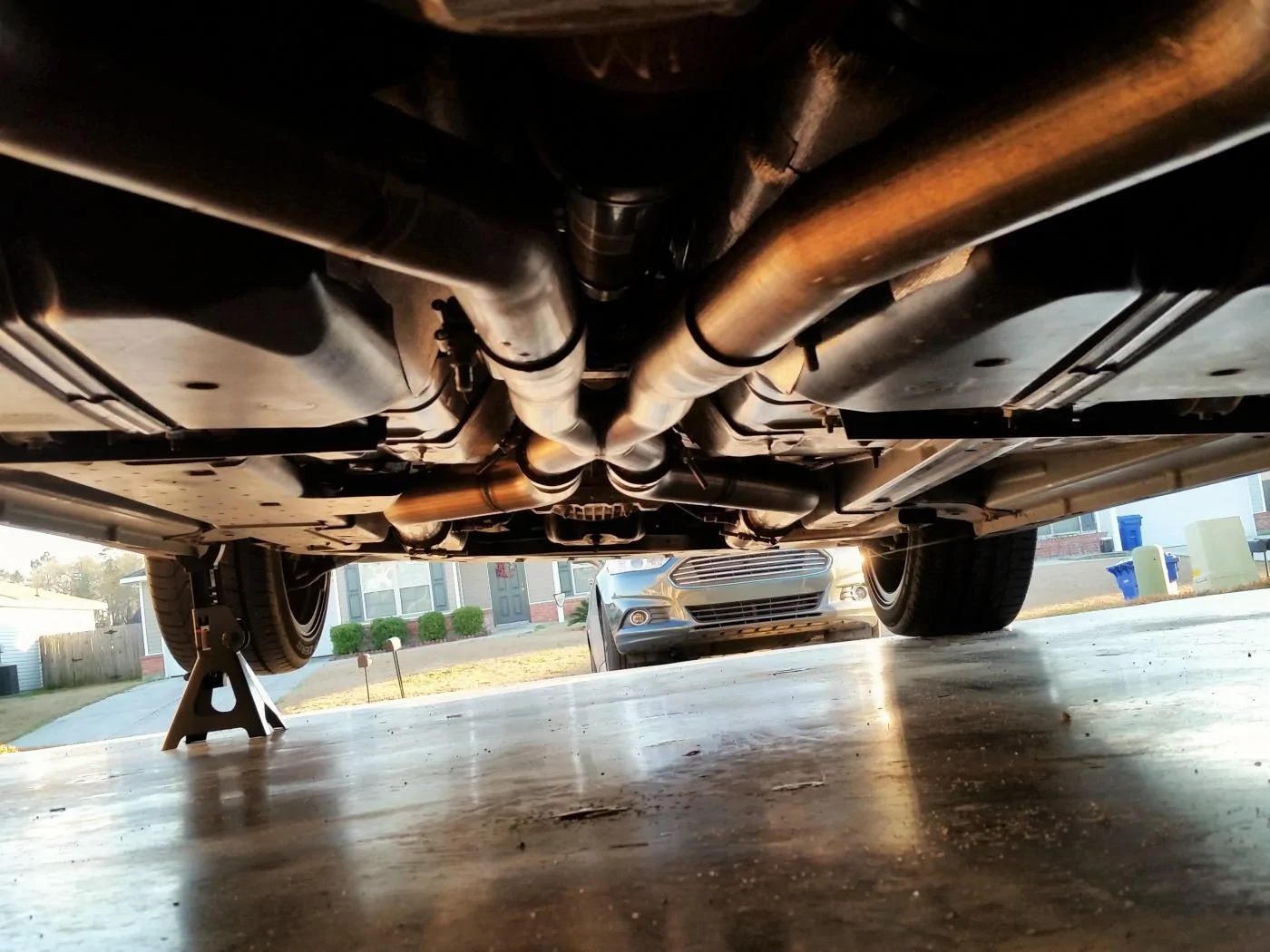

Hey Guys,
Below is just the Summit X pipe and the magnaflow mufflers. Rather than spending $1000+ on a catback of good sound quality, I decided to put something together myself. I have been welding and fabricating my own exhaust for years now on various vehicles I have owned. The 2015 Mustang GT catback piping is actually very nice with mandrel bends and dual 2.5" piping from the resonator to the rear mufflers, I wanted to maintain this. 3" is not necessary for the direction I am going. My exhaust consist of an x pipe/ resonator delete and I removed the factory mufflers and welded in two magnaflow mufflers that I carefully chose to fit in the factory muffler location. The idea was to retain as much of the stock piping as possible. After about an hour of designing the stock mufflers in solidworks and designing several different mufflers that I could purchase to replace the stocks with, I finally found a perfect muffler that will flow very well, fit perfectly, and sound amazing. This setup came out just as I was hoping it would. I finished off the catback with 4" 304 stainless tips that really set off the exhaust well.
I made different videos from two different devices just in case sound quality or picture quality was any better from one to the other.
[ame]
[ame]

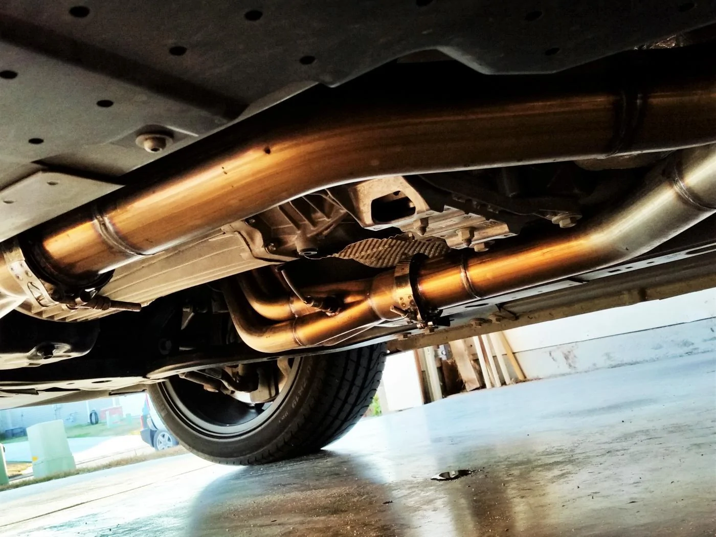

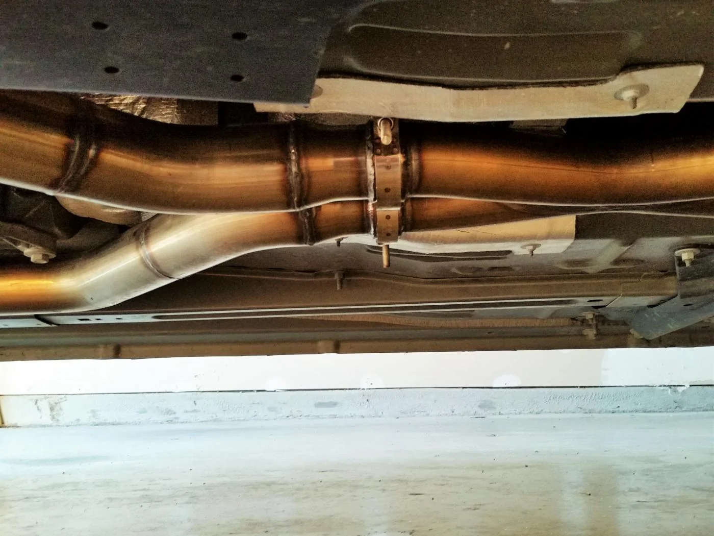

I wanted to update the thread of pictures of my header install and custom connection pipe build. I want to thank my good buddy [MENTION=10548]cp5899[/MENTION] for his help installing and welding as I blindly made the cuts to build the connection pipes. The header install only took 4 hours or so, building the connection pipes was a pain in the ass and took an additional 5-6 hours, laying on the ground did not help. Looking back, I should have just bought the connection pipes with the headers, I saved money, but a lot of time was spent doing so. However, I did eliminate the 2 1/4" bottle neck slip fits and welded in true 3"-2.5" reducers to replace them. I bought the headers on a holiday sale for $475 shipped, spent $150 in the piping, $70 on the "V band" clamps, $175 on the stainless x pipe, $250 on the mufflers and tips. So total I spent around $1100 for all of the components for my full header back exhaust. I guess that's cheaper than buying it all lol. The headache almost didn't seem worth it. Plus I hate the rasp, so I'm going to be installing resonators soon to help eliminate that as well. I'm hoping that will be the end of it. Let me know what you guys think, videos of the new sound to come.
Let me know what you guys think.
Kris
