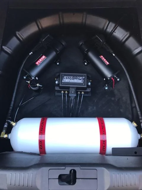

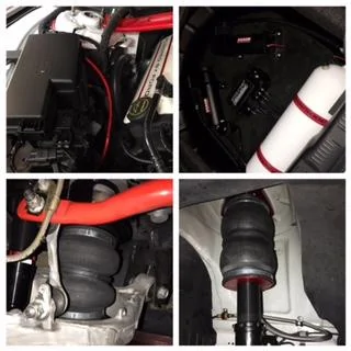

Thanks to all tha praise given by D4rk_hrs and Jmeo, I just had my 3P system installed. I totally copied Jmeo's setup as I use my Stang for work and constantly have tools as well as parts stored back there. Big thanks to them for making up my mind about AirLift. ��
Hey! Lol, looks great an I am very glad to help :D

Picked her up on Friday and have already driven 200 miles on the Airlift. So far it is a great investment...Wife loves the way it rides compared to before.
