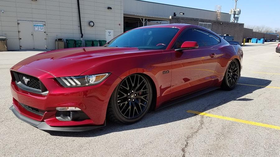

Strange thing happened this morning, twice. Will try to explain it so it makes sense.
Go out to car and start the engine to warm it up before leaving for work. When I do this I leave the bags at 5 or so (where I leave the PSI while parked, per the instructions). Come out to the car 6 or 7 minutes later and press the preset ride button to get the bags up to start driving. The controller just starts flashing the 3P symbol and won't stop. At this point the bags did not inflate. Recycled the ignition and the controller worked properly to inflate the bags. Then get to work, park, hit the all down button and get the same flashing on the controller. Again recycle the ignition and controller works properly so I can deflate the bags.
Any idea why this would start happening when it worked fine the past week? I don't think its the cold since its actually been pretty "warm" for this time of year (about 40-45 daytime low 30s at night).
