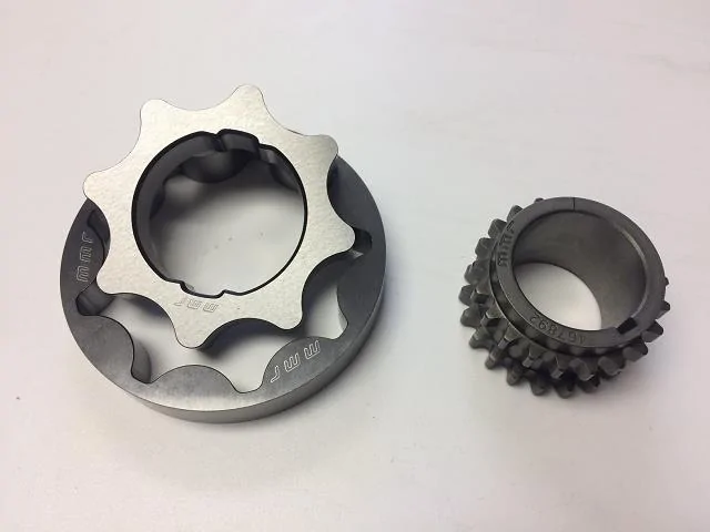

The oil pump gear and crank gear. Also if you plan to rev over 7200, get an ati damper its still a good idea to combat harmonics despite the upgraded gears. OE damper is not suited for higher. Its only a bandaid to just do gears, not a cure. If you shop around you can buy all 3 for around 900 shipped.

TSS billet oil pump gears, skip the GT350 pump as it is not an upgrade. Plus what mustang_guy said.

I'd do stage 3 comp cams, LT headers, oil pump & crankshaft gears, GT350 manifold depending on the budget.
