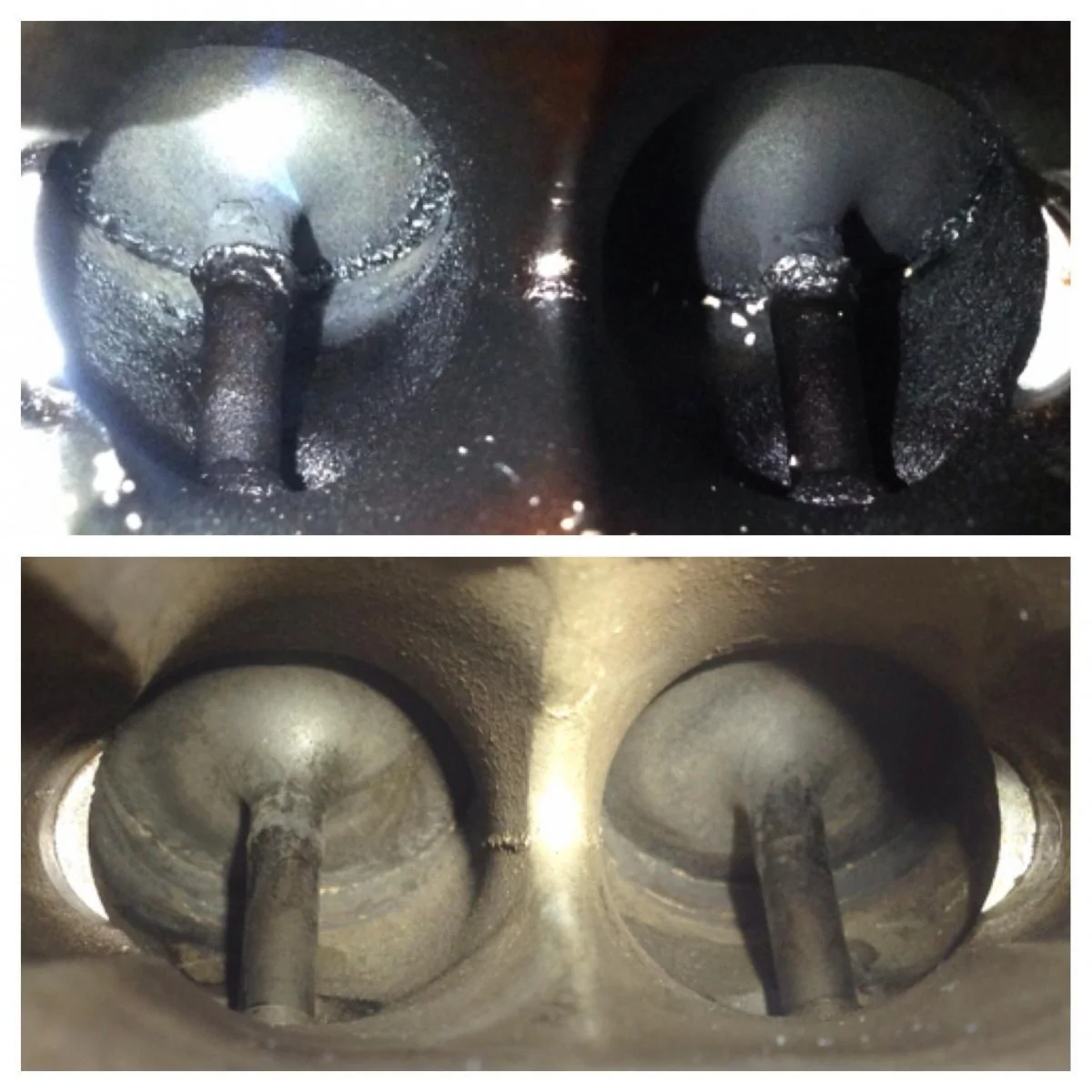

While not the same engines, still the same mechanics. My 2015 WRX FA20 DI engine at 43k miles, no catch can. Only reason I had it blasted was because I installed port meth injection so figured I'd get it done since I had everything off.

I think the valves in the above post on the WRX looked good with 43,000 miles on them.
