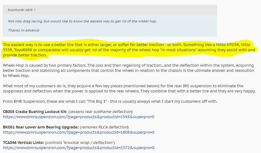

I agree with you. Below is a post from BMR Tech that helped me decide on wheel hop solutions. I am sort of surprised that he didn't suggest Mickey Thompson DRs but he makes very good points.
