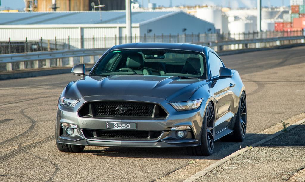

No idea if it will fit over the GT350 brakes, but this is my 16 PP with CF5V 20x9.5+30 275/35 and 20x11+55 315/35
Standard fitment for a 20x10 on a PP is +35 offset, +11 will poke for sure
I think +55 is the best for the rear, you can get very close to -1 camber with a 305 (mine is -1.4 in this pic)

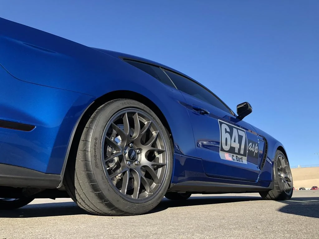

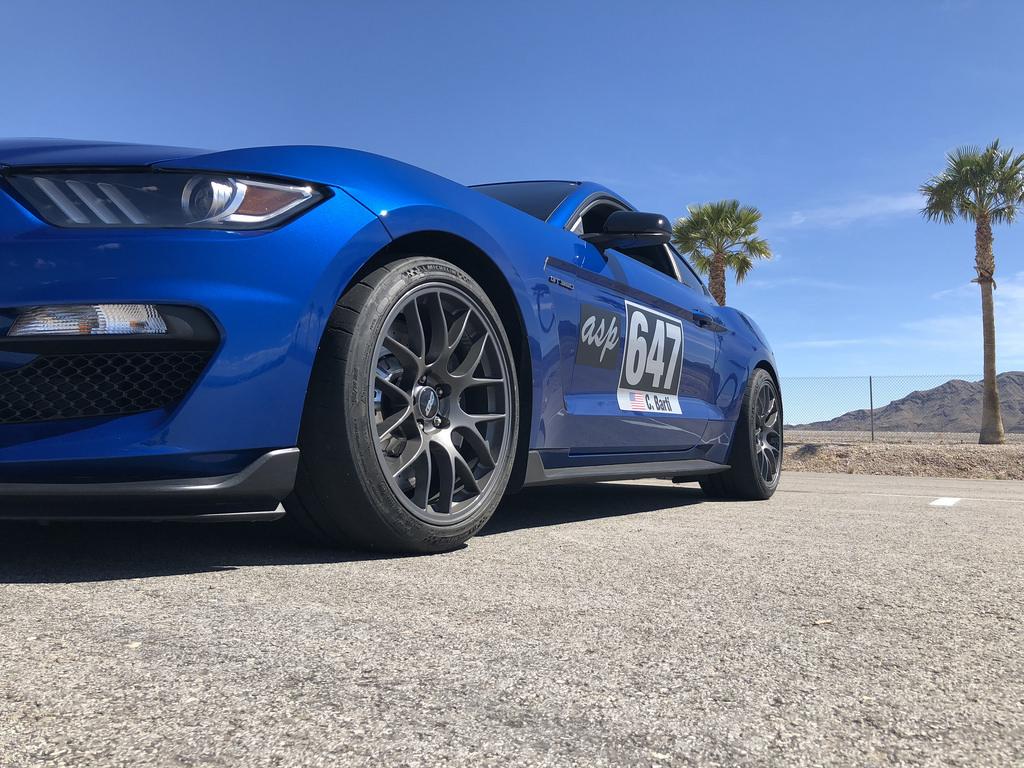

This GT350 is running our 19x11" ET52 in the rear with no other mods and fitment is on point. He is also running the same wheel up front with a 25mm spacer and extended studs.
- Cory

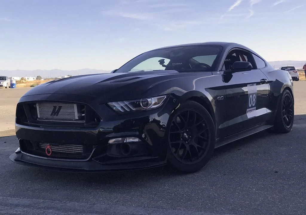

I could not tell you an exact number as I do not know for certain. It is obviously fairly insignificant from our testing. Here is a car with regular brakes and 11" rear wheels with +52mm offset.

Pictures have a close enough angle on the front view toward the rear wheel to conclude it's about 5mm difference.
