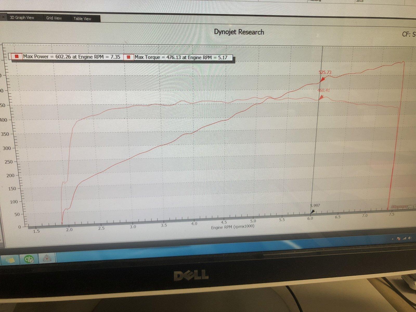

The problem occurred from a factory part failing in the engine, nothing tune related, nothing that the customer did himself, just bad luck with bad gas PERIOD. You cant get garbage gas and expect a 11:1 Engine to live with stock parts.
So here goes, customer went to a dyno day. The dyno operator said to the customer its knocking excessively. He made one more pull and still heard knock (WHICH WE VALIDATED THE CUSTOMER STORY IT IS TRUE). We seen the graph the second run has spots in the graph that had 40 HP difference. Why because the Knock sensor was pulling as much as it could out. But if the gas was literally 87 Octane or not 93 this stuff happens.
Now the customer came back to us and we re-dynoed it and low and behold the factory knock sensor was actually adding timing? Why cause this was several days or week later and the customer had been through the bad tank of gas and it was doing what it was supposed to with correct gas. And no there was no drops in the graph or sounds of knocking when it returned. But unfortunately the damage was already done. Read any car that requires premium gas owners manual and you will see it is required to run premium! Anything other than this can RESULT IN SEVERE ENGINE DAMAGE.
I'm sorry you want to blame Livernois for all this nonsense but in this case we have a smoking gun verifying that there was audible knock from another shop. This happens places get bad gas. I dont know what to tell you we have hundreds of these tunes and these kits out there with no issues.
Look we did what we think is the right thing to do gave the customer a smoking deal on the engine because of what happened. Stop with the nonsense.
Also this car has made over 600 RWHP now and will most likely make even more we are setting the thing to run close to 8000 RPM.
And we are going to make sure the customer drives this car before its released to ensure the drive ability is dam near perfect.

601/476 with a cai and race shirt block and 3.1 pulley hmmmm
Mine made 591/478 with stock air box and stock block and 3.3 pulley.
Makes no sense to me.
If you look at the graph the number continues to climb, this cars not done and still has some more in it, will update with final numbers upon completion!
So you gonna make more power by going to 8k. Hmmmmmm why is not making more at 7300 then same car with no cai or race short block lol.
