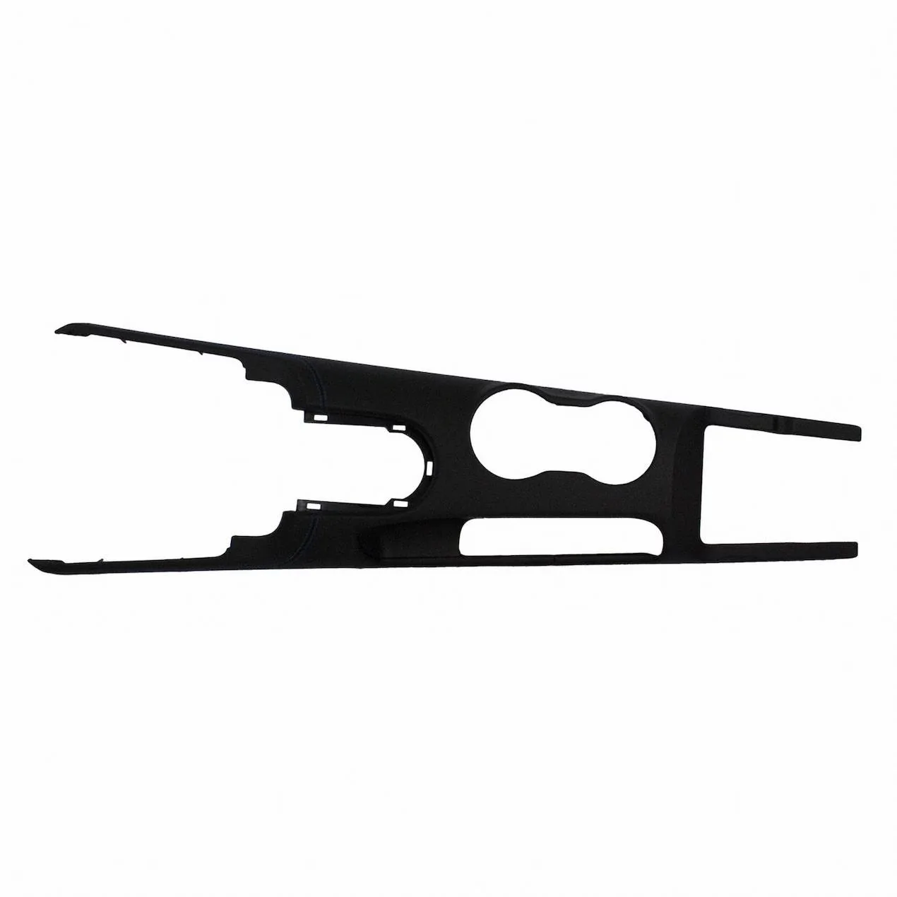

Will a 2018 Console Trim Panel fit on a 2015 V6

I had a prior 2016, I have a 2018 - the only difference I know of with the console section for 2018+ is that inside the actual console it no longer has the headphone jack, it has the CarPlay USB, and at the front of the console (under the center stack), the plate no longer said “Shaker” even if the car was equipped with the premium sound SYNC.
I do not believe there is any difference at all with mount points or the skeletal structure itself. It should be a direct swap out. There’s been threads on here with folks putting in the stitched kick panels or swapping console/dash pieces here and there.
Unless there’s something being overlooked, someone else jump in, but swapping console parts between a 2015-2017 and 2018+ should not be a problem at all (the whole body shell and interior was the same regardless of Powertrain).
