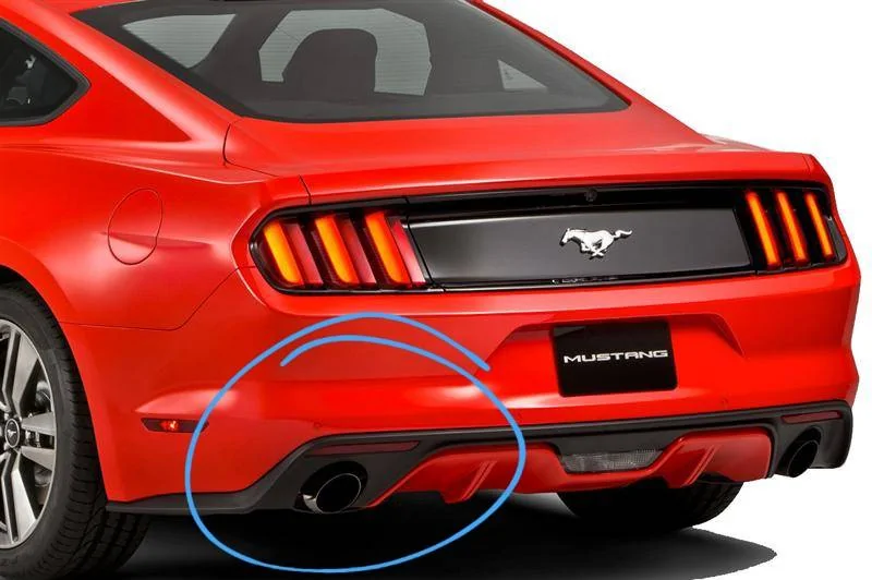

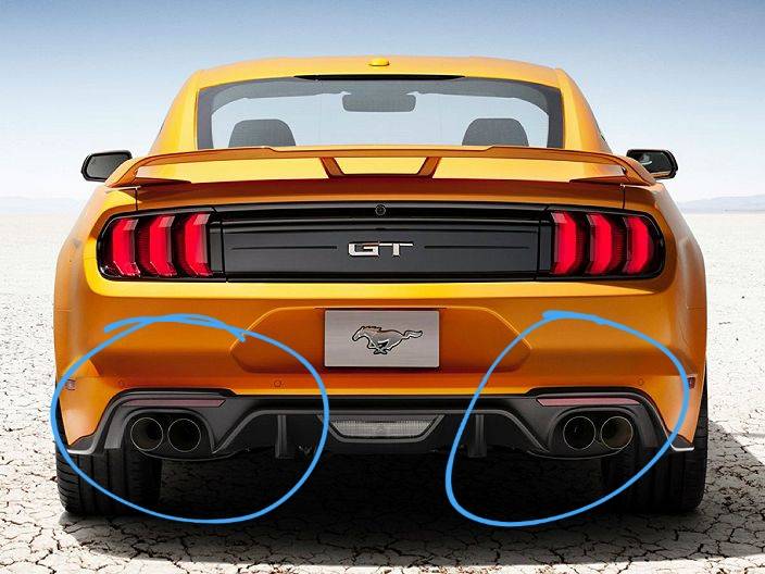

Im not sure if you can put a 15-17 rear bumper on your 21 ...if you can then you can add the gt350 rear valance.
I've circled them in blue. The 15-17 is smooth. 18-21 isnt.
