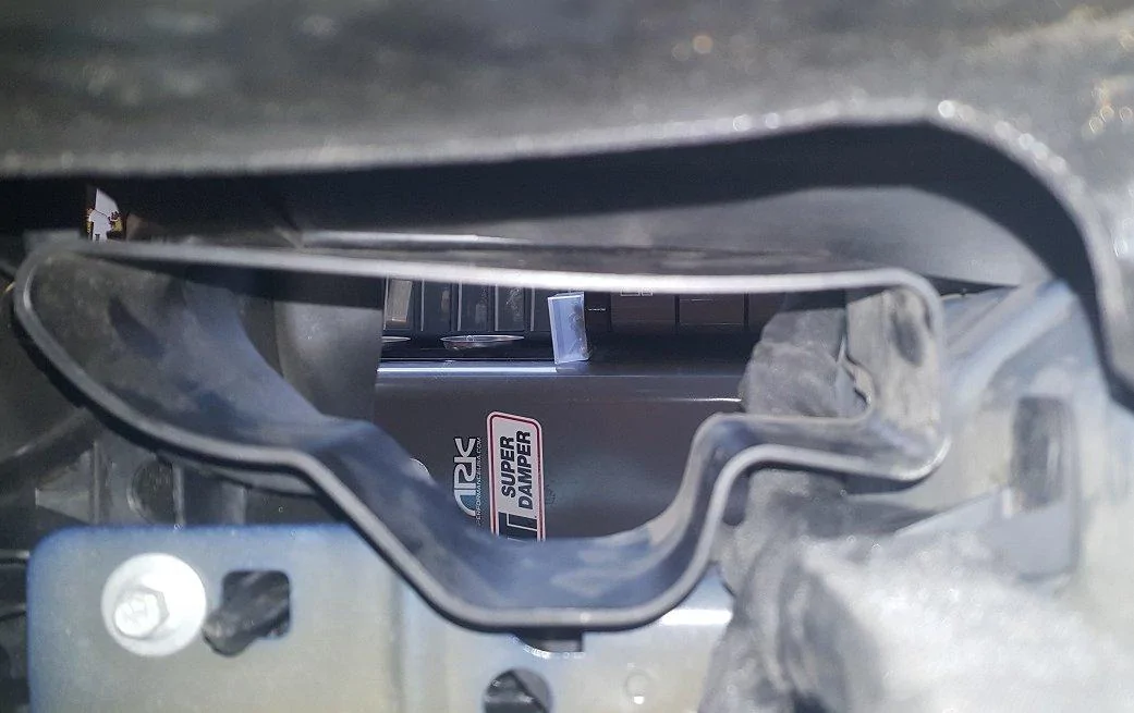

Here is a picture of the gap coming from the factory air inlet in the grill.

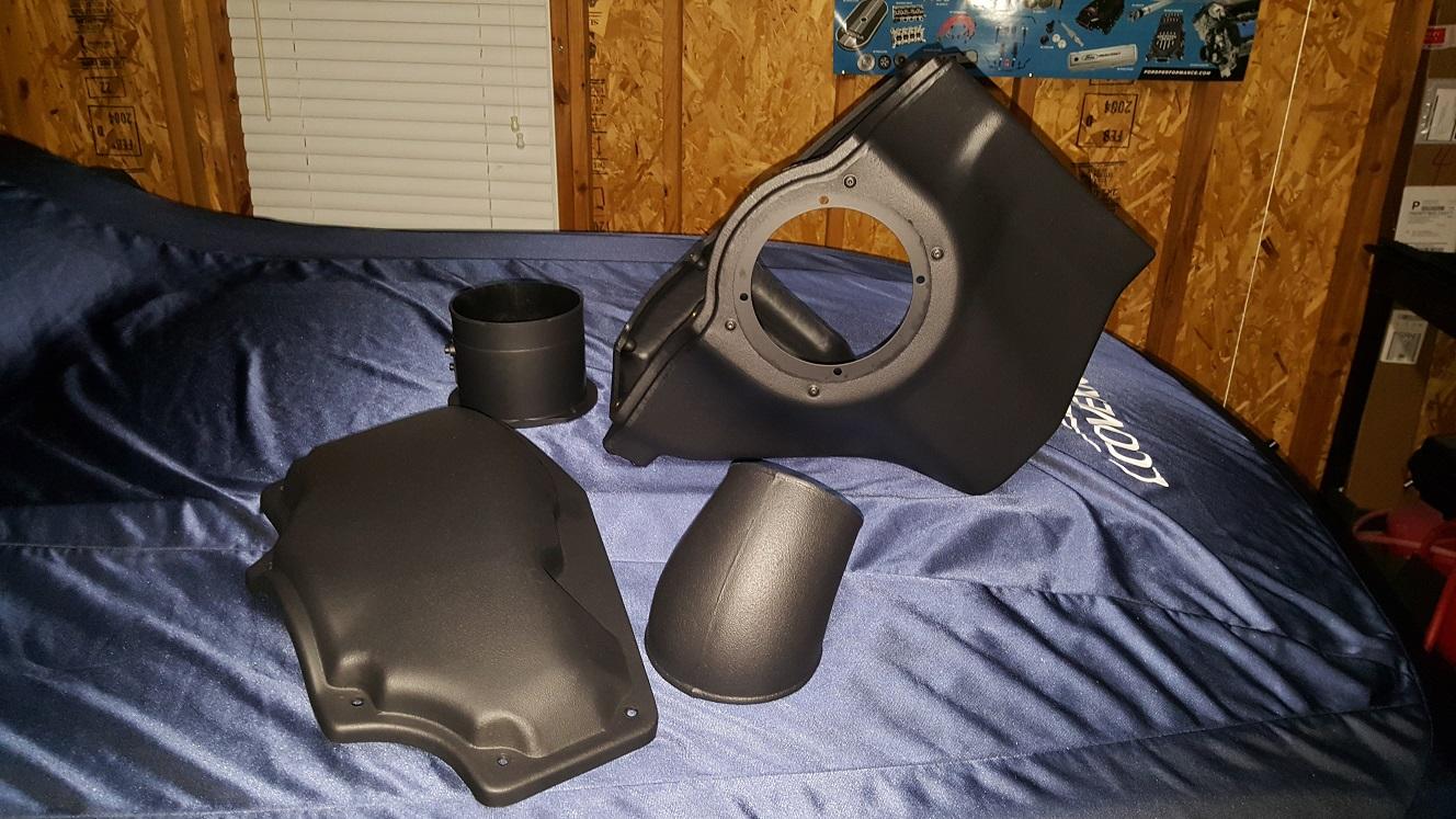

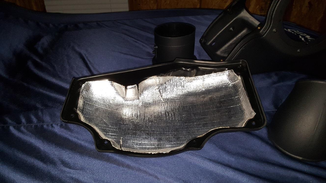

Intake with Cerakote
Below are some pics of the intake parts with the Cerakote satin Black and the liner in the top of the air box cover.
