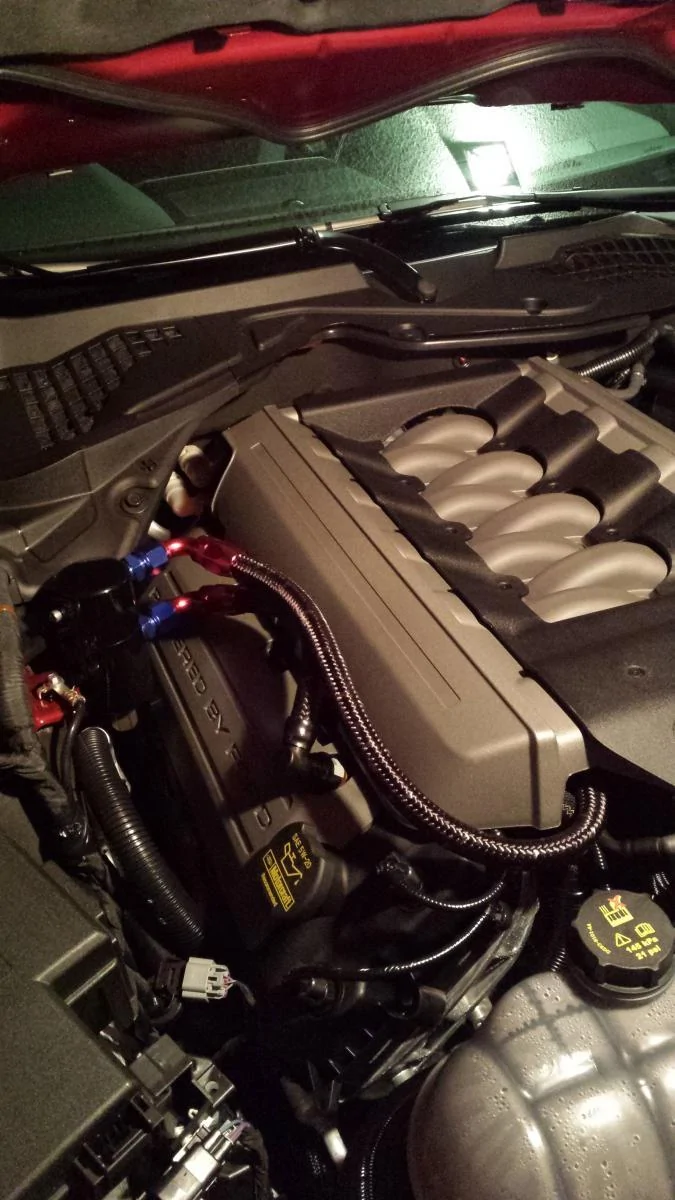

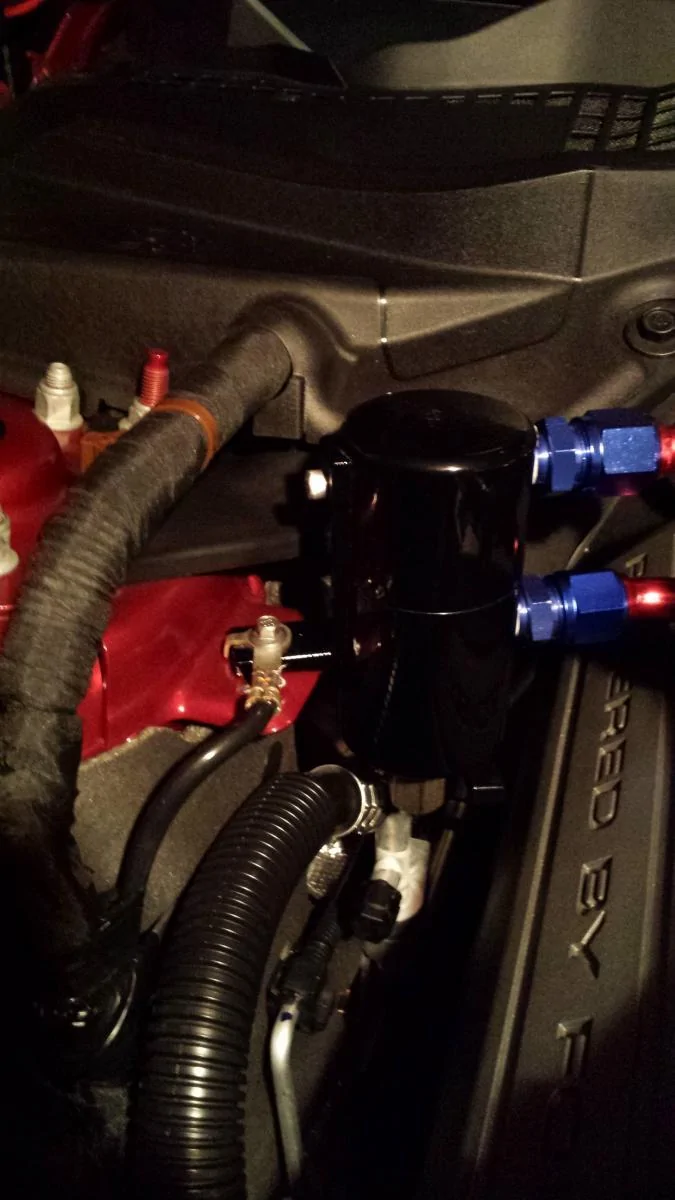

Just a quick update for you as some PCV systems work better than others and ring seal etc. But after looking at the picture of the JLT mounted on your car it's only protecting the top half of the sysetm and exposing the rear line. The JLT mounts on a T right at the back of the valve cover and it only protects the up line and not the line going to the back of the blower.
You should really look into a Bob's or ask JLT to install the system correctly and have the can go between the valve cover / dirty side to the feed the T not just split the T at the Top and let the bottom stay wide open.
BTW, VMP rocks and I love his setups.
I'm glad you have had good luck though.
I'll be the first to admit, I'm not an expert on the ventilation systems on these cars.
However, I'm pretty familiar with them and have a substantial amount of experience with the latest generations.
I can see on paper, and in theory how the exposed line could allow for unwanted oil vapors/residue to enter the lower manifold. As I stated above, we run this same system I have pictured on our VMP Supercharged 2011 GT. I've got that car torn apart right now in our R&D facility, and have inspected every part thoroughly. I can assure you, that exposed line did not allow any noticeable oil through to the lower intake. If I did see anything that concerned me, you can't possibly believe I'd put the same system on my brand new supercharged S550 that I've worked very hard for. :thumbsup:
As for my car, I've spent a tremendous amount of time building it with prototype parts. As you can probably imagine, most parts have required some attention to get set up properly, and in perfect working order. Especially the mods that I've had to make myself, due to non existence. The tuning process has begun, so I plan on having results soon. Of course, that's a chore in itself due to there not being any other combos like mine out there.
