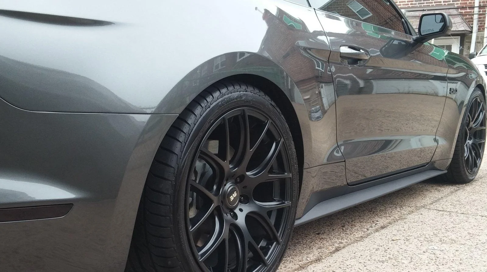

Here are a few images of our Mustang (Excuse the unclean state of it on similar set up but with 20"
20x10" ET25 (Aggressive so go ET30-35) at the front Tyres: 275/35/20 Could go 285/
20x11" ET50 - Tyres 305/30/20 can go 315 but finding tyres in this size is hard/expensive as they are not as popular over here.
We can now supply Project 6GR & will shortly be adding the wheels to the website for a classic concave 5 or 7 spoke design.
Black Friday Offers and Discounts to also be announced shortly!
Edit: Images don't seem to be working so can use this link: https://www.dropbox.com/sh/v50kvfwe7bydae3/AADN-eIJZi3U5m3YUCewkOWxa?dl=0

those tyres look stretched in your photos to me guy :(

From the comment on mine looking stretched:
With the 20x10 could go with a 285 then and with the rear the 305 tyre has a rim protector that makes it looked a little stretched. Also when you go 19" you will have more rubber side wall and wouldn't look stretched at all.
With those Judd wheels you could go with a 19x9.5 Squared and would imagine they should provide enough clearance.
Here is 19x9.5 ET35 Square on 275/35 Tyres. I would possibly go 275/40/19 These are the same as the GT factory wheel 19x9.5 (ET52.5)

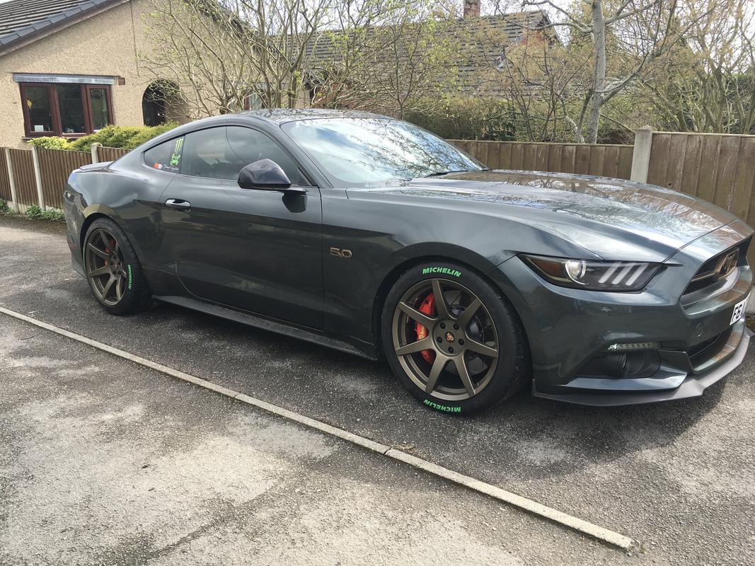

https://project6gr.com/product/project-6gr-19x10-19x11-5x114-3-3550mm-gold-flake-bronze/
this is the colour closest to what i'd like to end with but i really don't like the 6gr 10's :( also damn expensive.
275's no where near enough wide enough as i said i have a very specific fitment requirements just need to know what ET to tell them to make them to and what width.
That’s the colour of mine.....
I’m running 285-35-19 up front and 305-35-19 at the rear..

yeah thats near enough the sizing I want the rear rubber does look stretched though so for me a narrower rear rim would be in order. for me the start of the tread has to be at or beyond the outer edge of the rim else i get upset :)
what sizes are your wheels ? 11" in rear 10" up front ? and what are your offsets
Enoch
Feb 10, 2015
83
2,203
1,105
UK
Andy
Guard 5.0 (Auto) Fastback, Saddle Leather
11”R x 50mm offset
10”F x 35mm offset
