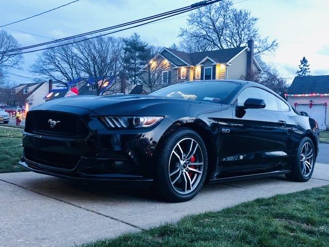

Hey everyone. I have a 2015 Base gt. Currently it has the stock 18x8 5 spoke with a 40 mm offset and running 235’s on all 4 corners

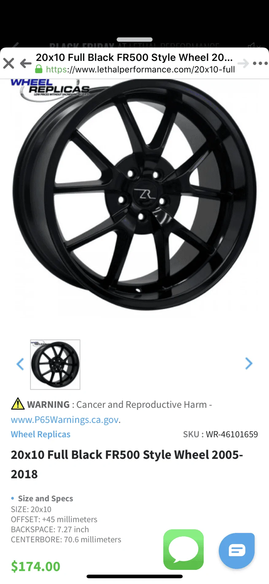

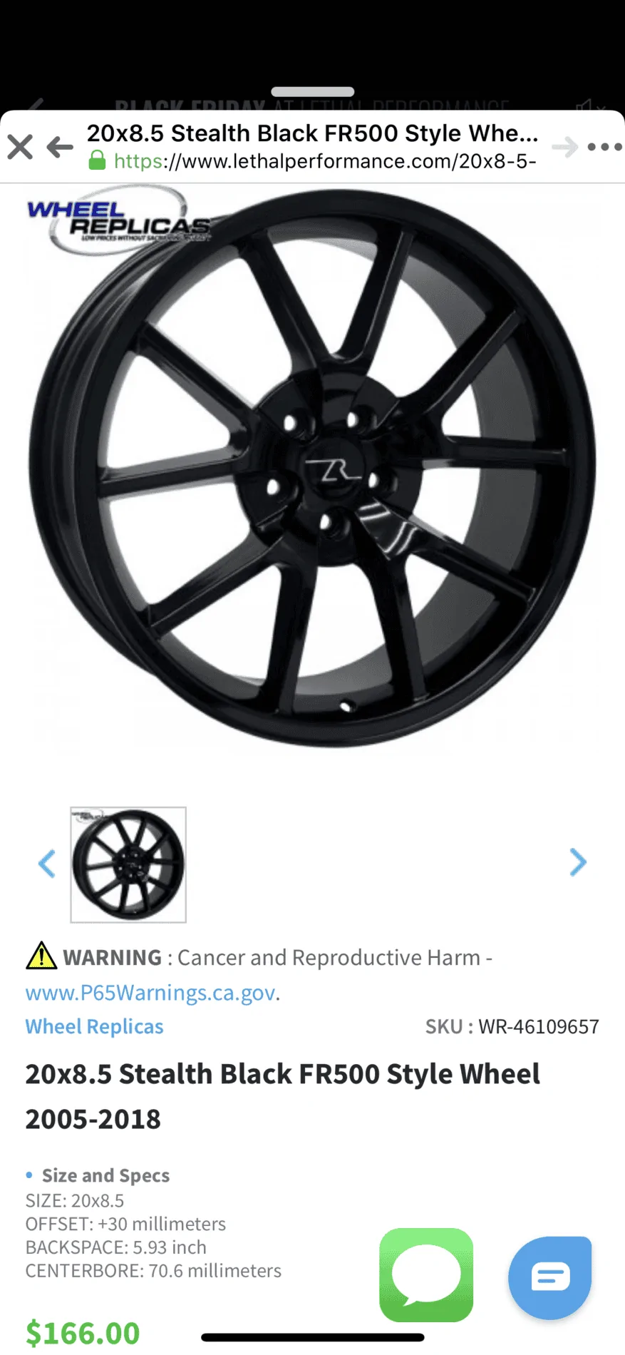

I have been wanting to put a set of staggered FR500s on this thing for a while now. The desired wheel and tire sizes are
20x8.5 +30mm offset with 245/40/r20
In the front and
20x10 +45mm offset with 295/40/r20

You will not have a fitment issue however, your speedometer will change. You may want to consider going with 285/35 in the rear. That should limit the speedometer change and , to me, be more aesthetically pleasing.
