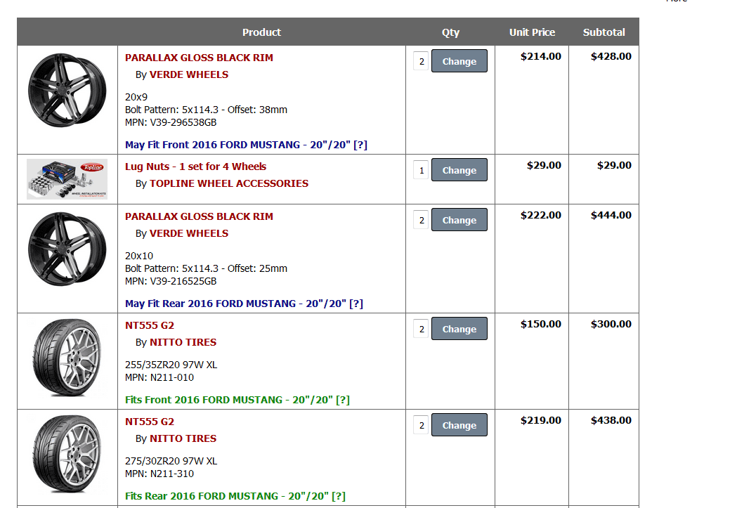

Verde Parallax V39
Front
20x9
Bolt Pattern: 5x114.3 - Offset: 38mm
MPN: V39-296538GB
Rear
20x10
Bolt Pattern: 5x114.3 - Offset: 25mm
MPN: V39-216525GB
Tires are Nitto NT555G2

Nice combo I carry those wheels if you want a bit more helo.
Also your offsets are off
20x9 ET 32
20x10 ET 45
Thats what you want.
