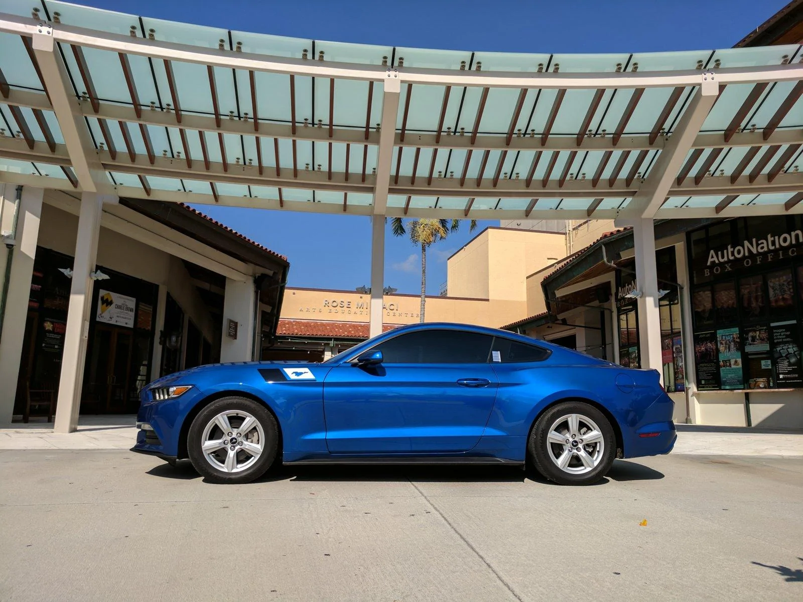

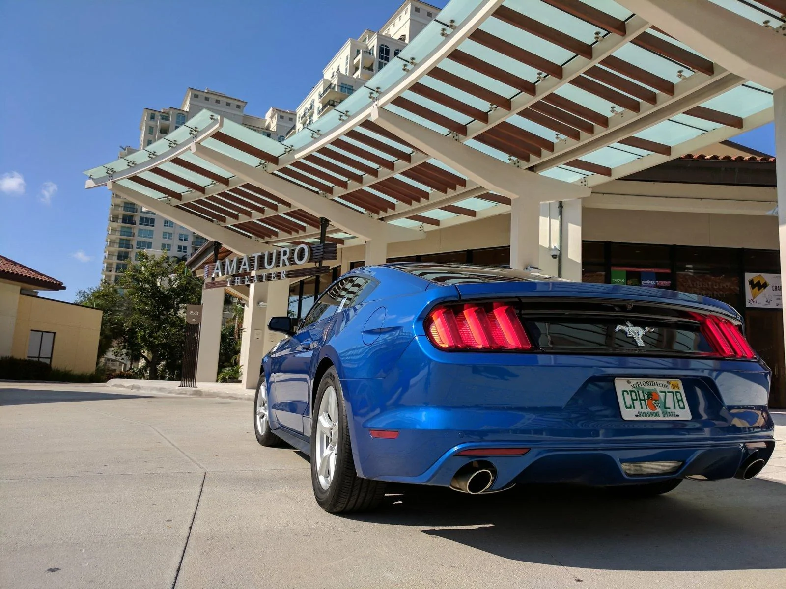

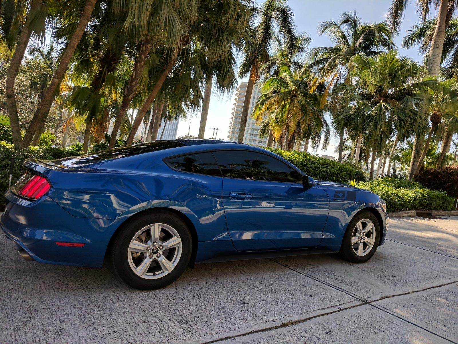

I think these pics are just the spacers but before springs...not 100% certain though.
All around the car or rear only? And what size did you use?

All around, 25mm
