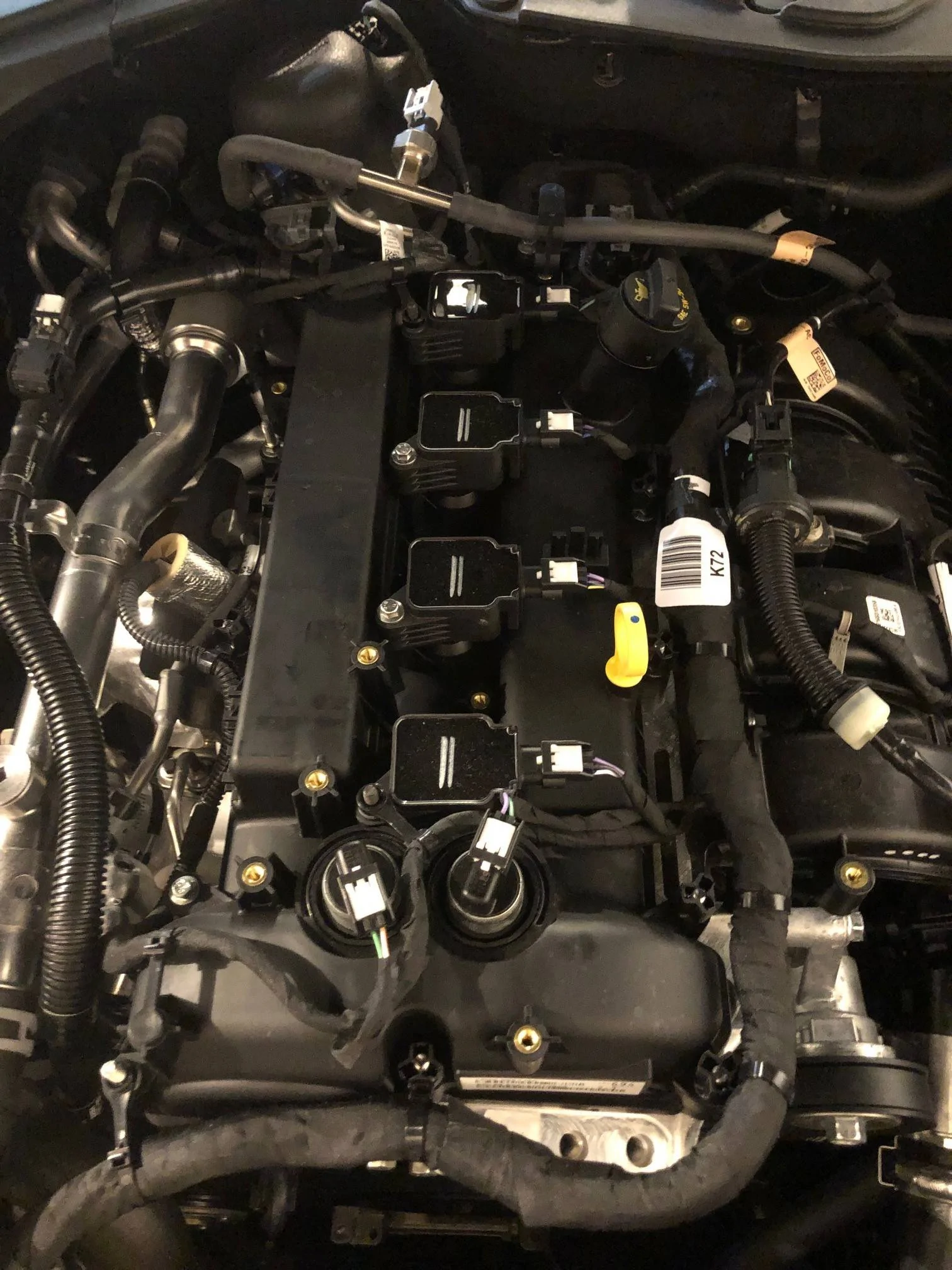

I apologize for my ignorance on engine details. I'm not quite sure what I'm looking for but hoped a picture I took will help you confirm your questions. There are a number of brass colored inserts where bolts could go, and one or two bolts that look like a nut could fit. Thanks!

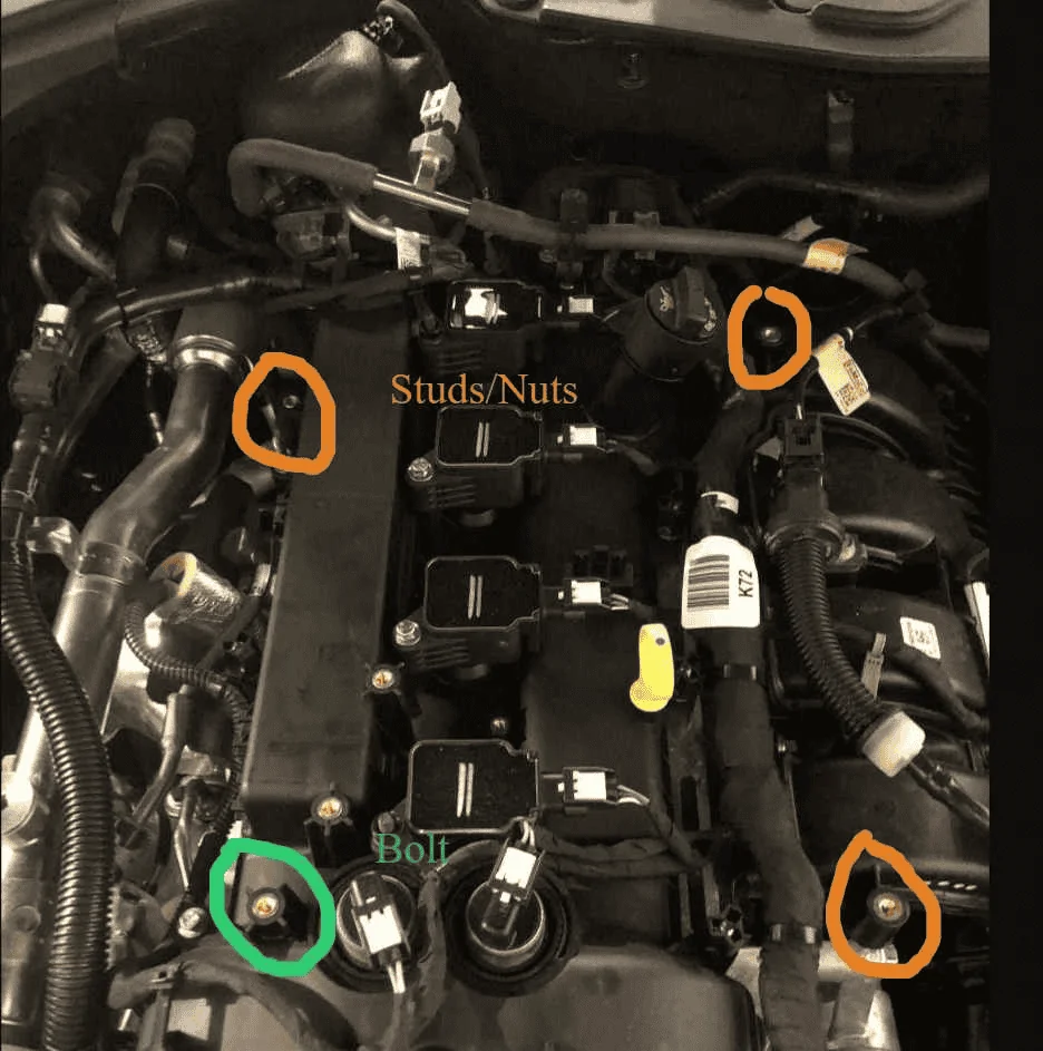

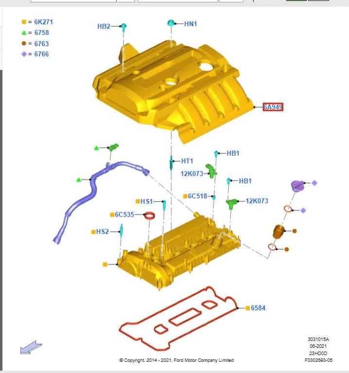

Hmm, this is what I am thinking based on your photo and photos of the cover itself
With that said here are the qty's and links
1 Cover
https://parts.levittownfordparts.com/oem-parts/ford-engine-cover-fr3z6a949c
3 Studs
https://parts.levittownfordparts.com/oem-parts/ford-stud-w717107s450b
3 Nuts
https://parts.levittownfordparts.com/oem-parts/ford-condenser-nut-w520412s441
1 Bolt
https://parts.levittownfordparts.com/oem-parts/ford-engine-cover-bolt-w700805s450b
I will send you a code you can use. Please let me know if you have any questions.
Thanks,
-Benny
