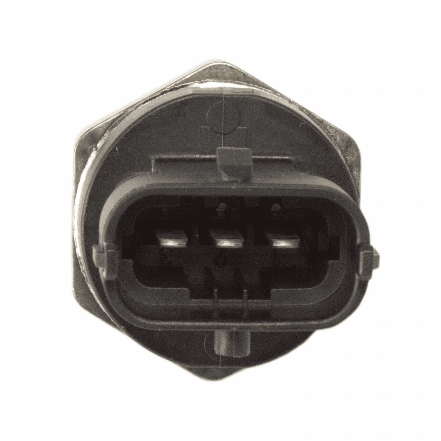

Hi Benny
I have a 2020 ecoboost premium mustang that I am looking to install the HPP gauge assy that has the oil pressure and vac/boost in center of dash. My car only has the oil pressure switch in the filter housing not the sender so there is only one wire to switch in harness connector.
Do you know if there is a separate jumper harness that will plug onto the main engine harness for the sender versus the switch or does the entire engine harness need to be replaced instead?
Any help with part numbers and possible other items needed for the gauge install would be appreciated.
Thanks Mike
Hi Mike,
When equipped with the PP the sender is different and uses part # CM5Z-9D290-B
This is a 3 wire sender
Off hand I do not see a jumper that can be added, I believe the wiring is part of the engine harness but I would search the forums here for additional info. It's not something I have worked on yet.

Thanks Benny
Yes, I am aware that the sender is a 3-wire unit versus the switch being a one wire unit. I was afraid that it may be the case that there is no jumper to go from the one wire for the switch to the 3 wire or the sender but rather a completely different engine harness between the non PP and PP cars.
I was just hoping you had possibly encountered this scenario already. I will definitely continue my research as I have acquired an eco HPP center dash panel from an HPP vehicle I want to use on my eco.

Benny
Do you know if there is a 3 wire pigtail available for the oil sender and if so do you have the part number?
Thanks Mike

Benny
Thanks Mike
There is Mike, It's HU2Z-14S411-BA
I also attach the wiring schematic , Start with 23-5 and you'll see the EOS. There not the easiest schematics to follow but I think I included all for that circuit.
Please let me know if you have any questions.
Thanks,
-Benny
The wiring diagrams are just what I needed to be able to splice into the correct wires to make the oil sender work, perfect.:like:
