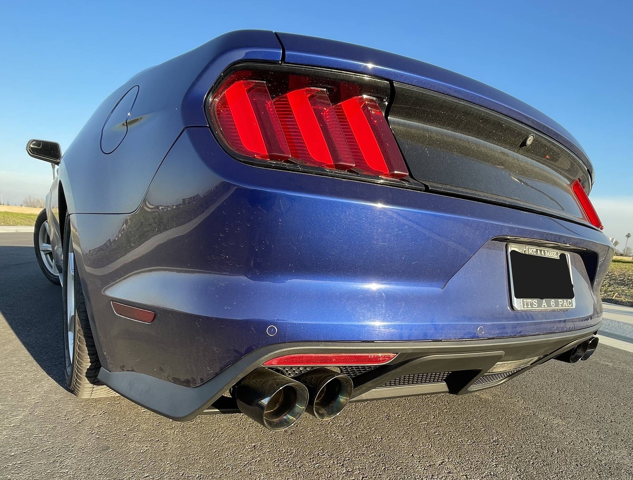

1. Handling, reliablity, OEM cosmetic updates? I can help with the first two, but the third is a waste of money...the 2018+ cosmetics do *not* fit 2017 back models in regards to grille, hood...maybe bumper with modification but undertray attaches at different points...lots of money. Handling and reliability I can certainly help with though. Or I am completely misunderstanding what you mean by ORM cosmetic.
2. What do you mean by performance? As I would say handling is a huge part of performance...do you mean power?
3. Another don't waste your money thing. You can read my post in another forum thread about my quad tip conversion with a full custom exhaust. Custom exhaust is the way to go. I will try to find the link. Here are old pictures of my quad exhaust.

Beautiful car.
Typo on ORM cosmetics, I meant OEM cosmetics, like pleather covered side panel on center console or pleathered center console.
About more performance, yes, I meant more power/HP
Appreciate it, she has been a work of love..and money.
