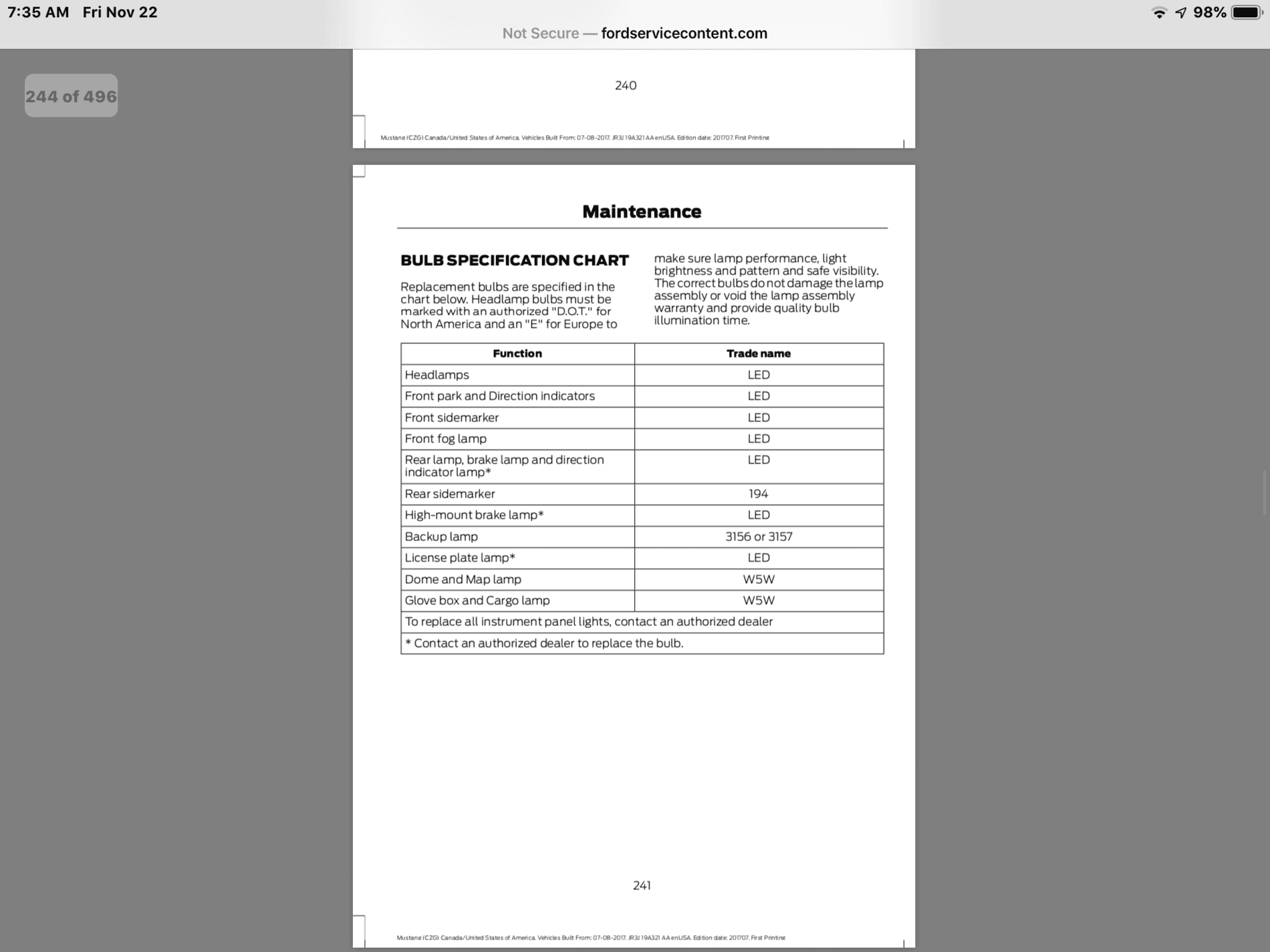

Cargo light in my UK MY19 is LED but map lights and glovebox are still bulbs
We have combined fog light / reversing light which are all bulbs but everything else is LED externally

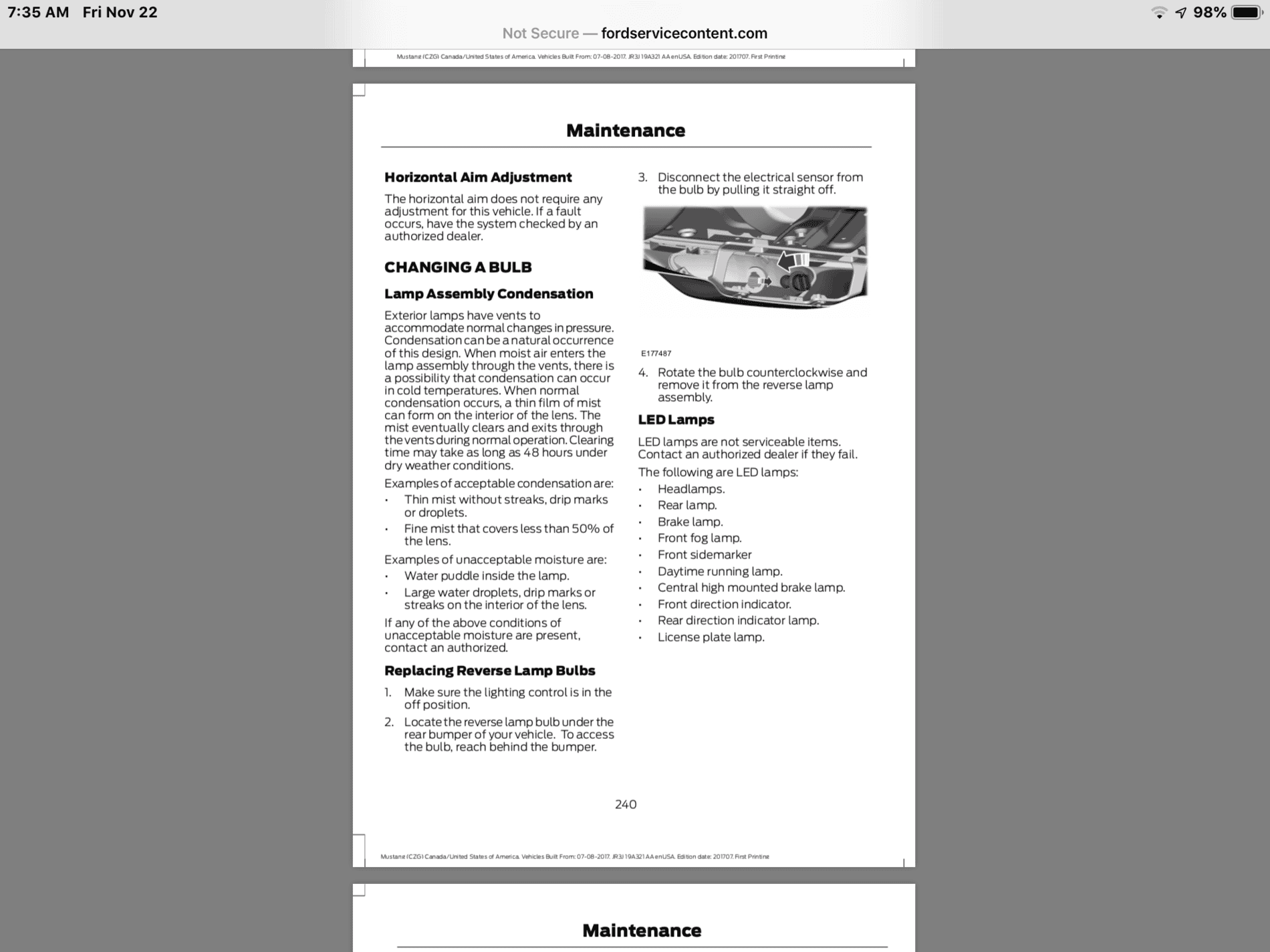

Good morning Shawn. Just FYI, this information is from your owners manual. :)
Duh! Thanks. I didn’t comprehend what I was reading when I read the manual, I guess
