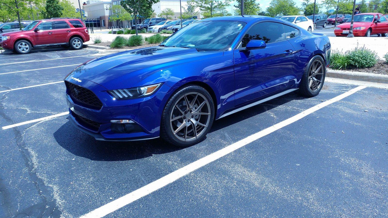

Finally got mine on
And heres a quick vid with them on
Tires are Continental DWS 06
275/35/20 for the front
315/35/20 for the rear
Have to say I freakin love the fitment and the wheels are gorgeous!

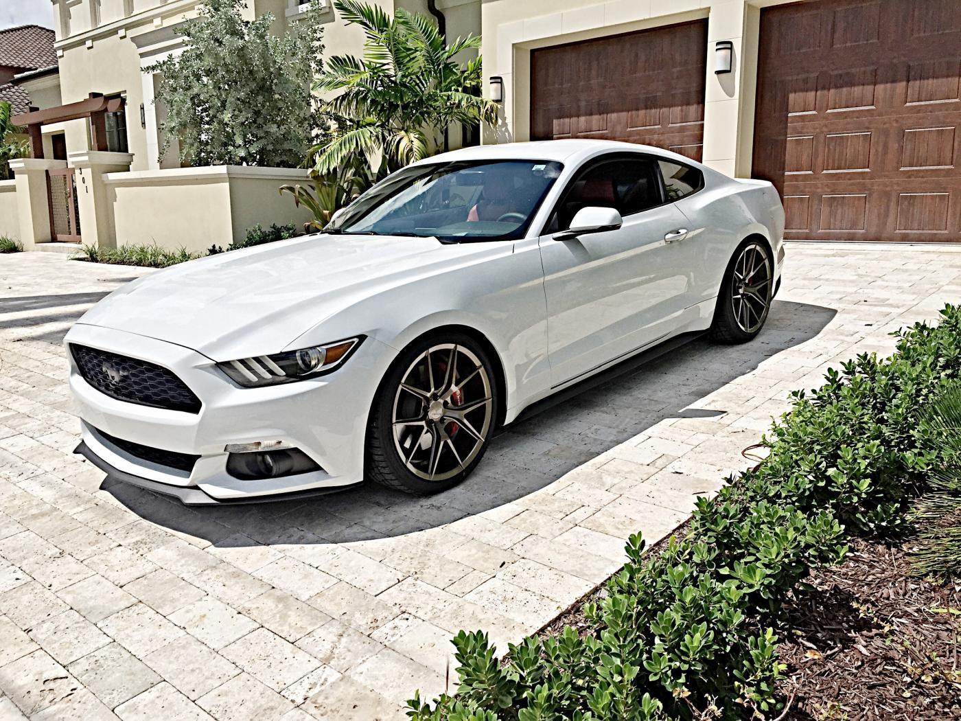

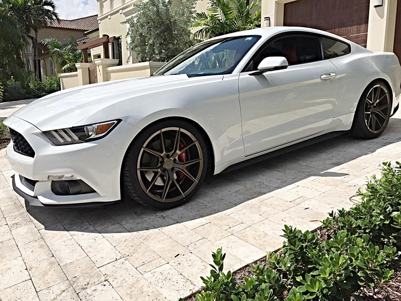

Specs are
20x9 in front 30+ offset
20x10.5 rear 25+ offset
Tires are falken e950
255/35/20 front
275/35/20 rear
