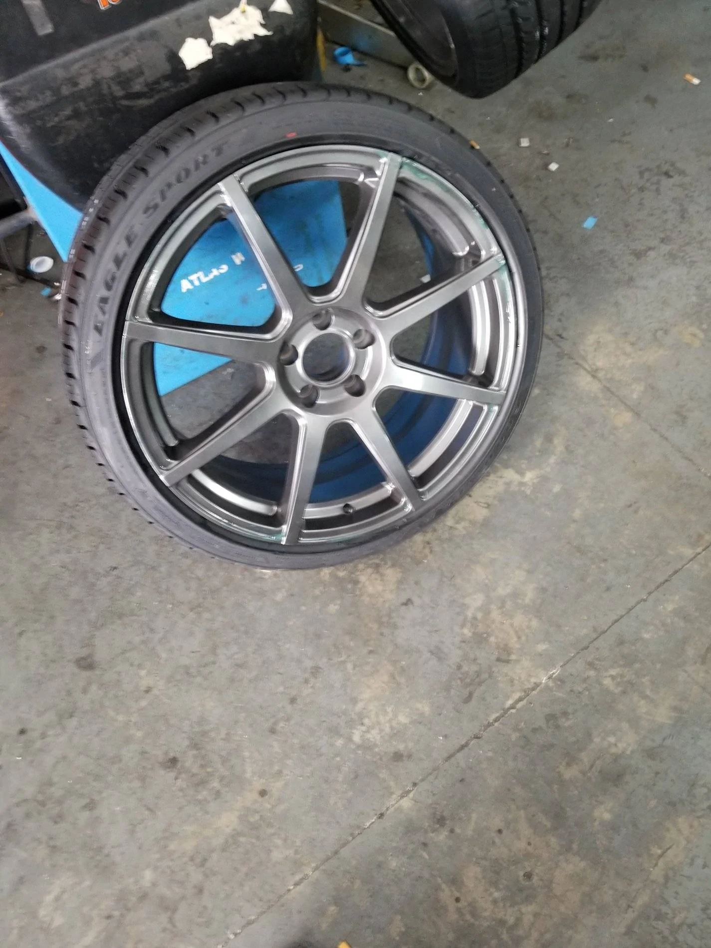

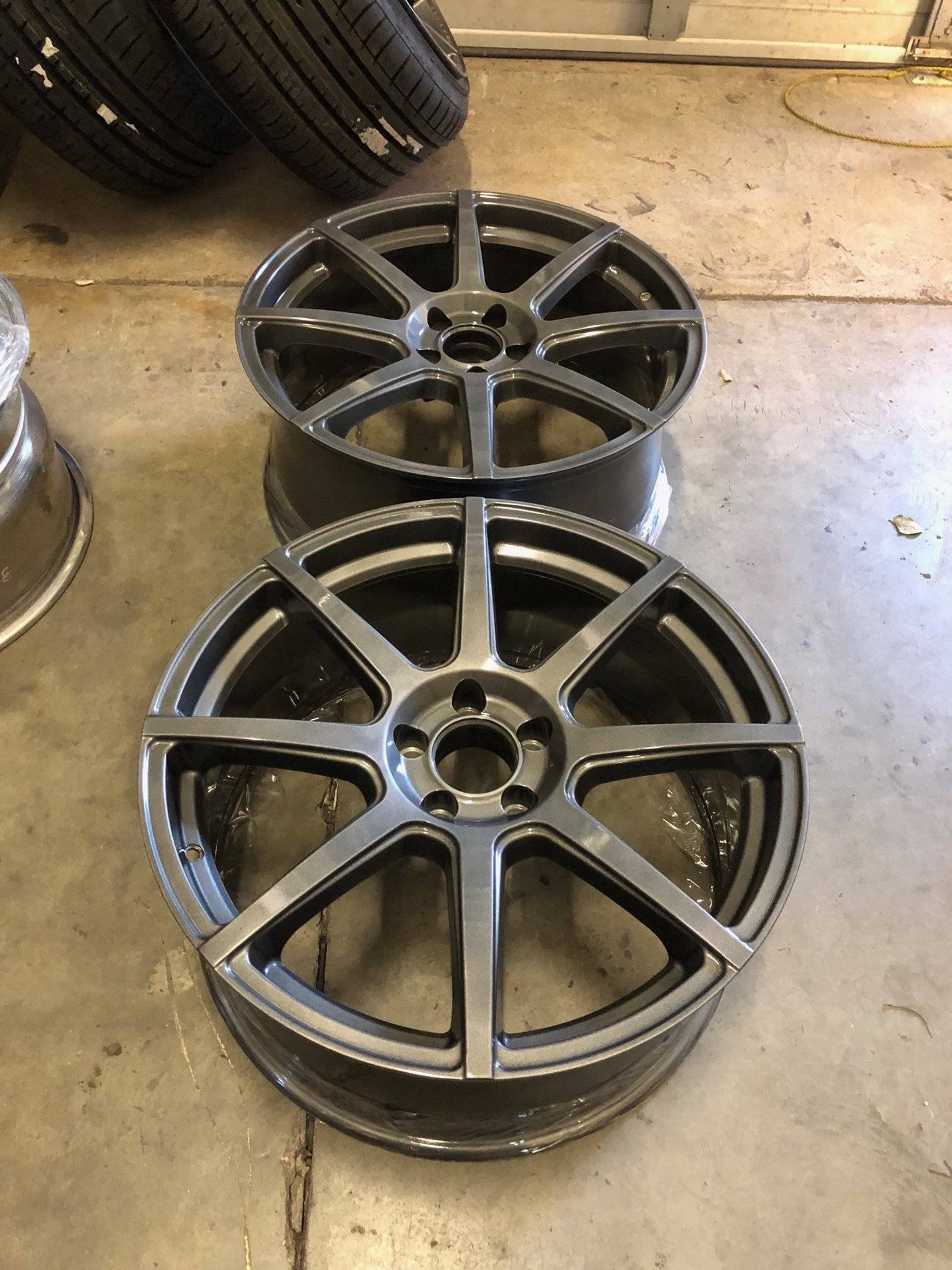

Hey guys I have a set of these wheels that are 20x9 35 offset, squared set up. I had them on my previous car but just got rid of it so I can buy a Mustang. What size of tires can I install on these rims that wont look weird.
Thank you for the the help,
David

I had them on an accord which is the same bolt pattern but requires a hubcentric ring

You're going to need spacers (probably around 15mm) to make up for the offset, that will add a pound or two to some very heavy wheels. You can put a 255, maybe a 265 on them, but I'd be inclined to consider other options to avoid sacrificing handling,
