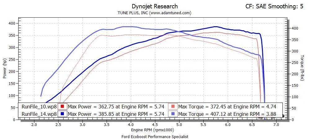

This is Texas weather so it was 103 degrees and about 120-130 charge temps on the pull. Imagine what it will do in cooler weather. This thread is intended to show how much more power you can make if you upgrade your to a reasonable downpipe when upgrading your turbo. This is Maperformance Catted downpipe along with their catback exhaust.

about 25psi on this dyno run. I've been as high as 28psi (Peak)

Awesome! Sounds like an easy 400 RWHP setup on a cooler day. I wonder how my setup will do with crappy 91 oct gas augmented by WMI. I live in the Phenix area, so I'll wait until the fall or winter to dyno.

Is this graph comparing stock downpipe vs map performance? Looks good.

Looks like it those are similar to my stock numbers with a tune.
I like the curve numbers, around 2500RPM he is making almost 100 more lb-ft of torque.

This was also about 103 degrees on the dash when I made that power. People in states in the north that are 10-20 degrees less would make more power. The Tune+ Dyno reads below most other dynos as well.
