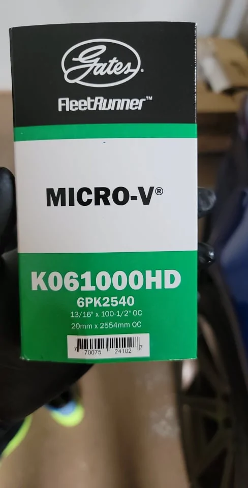

What PSI/load should my car be reading with the 3.33 grip tec pulley?
What is the correct belt size?
I tried the 102" in the second hole left to right and Lund says im not getting appropriate boost/load only 10-11 psi
Before I lose my mind please share any knowledge if you know the answers lol
What is the appropriate boost/load on 3.33 and which belt and bolt position with the 4 options left to right

I appreciate all of you, when i say snug that thing is on there lol. i used the 100.5 on the third hole left to right. will datalog and update info in case anyone in the future is searching around for the same answers

I have a new log too now that i got the 100 belt on.
