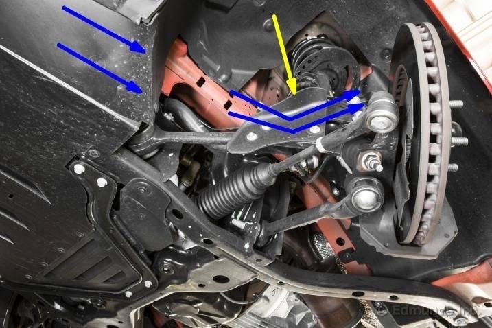

That's it for the most part. If you really want to you can also get the little winglets shown here, but you will need the PP link or to tap in your own holes to mount the fins, because the base car doesn't have those threaded holes on that link.
Sweet. Thank you.
