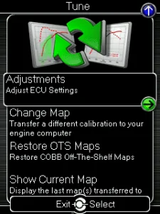

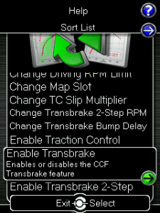

    To enable the transbrake feature go to "Tune" > "Adjustments" > "Enable Transbrake" > Set the value to "1" using the up button and press enter (center button).
    screenshot1-225x300.pngscreenshot2-1-225x300.pngscreenshot7-1-225x300.pngscreenshot9-1-225x300.png

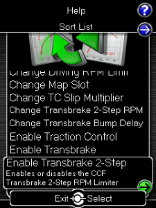

    Note that the default RPM setting with the transbrake feature enabled is 2500RPM. Greater boost pressures can be attained through increasing the transbrake RPM using the Transbrake 2-Step feature. Before continuing further, it should be known that transmission braking and bump box features are abusive to the engine, clutches, transmission, axles, tires, and differential. Only use these features if you accept all risks and responsibilities. To enable the Transbrake 2-Step feature go to "Tune" > "Adjustments" > "Enable Transbrake 2-Step" > Set the value to "1" using the up button and press enter (center button).
    screenshot1-225x300.pngscreenshot2-1-225x300.pngscreenshot8-225x300.pngscreenshot10-225x300.png

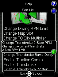

    Once the Transbrake 2-Step feature is enabled, the RPM can be adjusted. This can be done through the "Tune" > "Adjustments" > "Enable Transbrake 2-Step RPM" > Set the value to your desired RPM using the up/down buttons and press enter (center button).
    screenshot1-225x300.pngscreenshot2-1-225x300.pngscreenshot3-225x300.pngscreenshot4-225x300.png
    Note that the stock converter will be limited to ~3100 RPM. In order to reach higher RPMs additional modifications would be required.

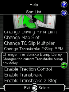

    You are able to change the amount "bump." This can be adjusted through "Tune" > "Adjustments" > "Change Transbrake Bump Delay" > Set the value to your desired bump using the up/down buttons and press enter (center button).
    screenshot1-225x300.pngscreenshot2-1-225x300.pngscreenshot5-225x300.pngscreenshot6-225x300.png
    For street tires we recommend using values between 12-15. For drag radials or slicks we recommend values between 15-20.
