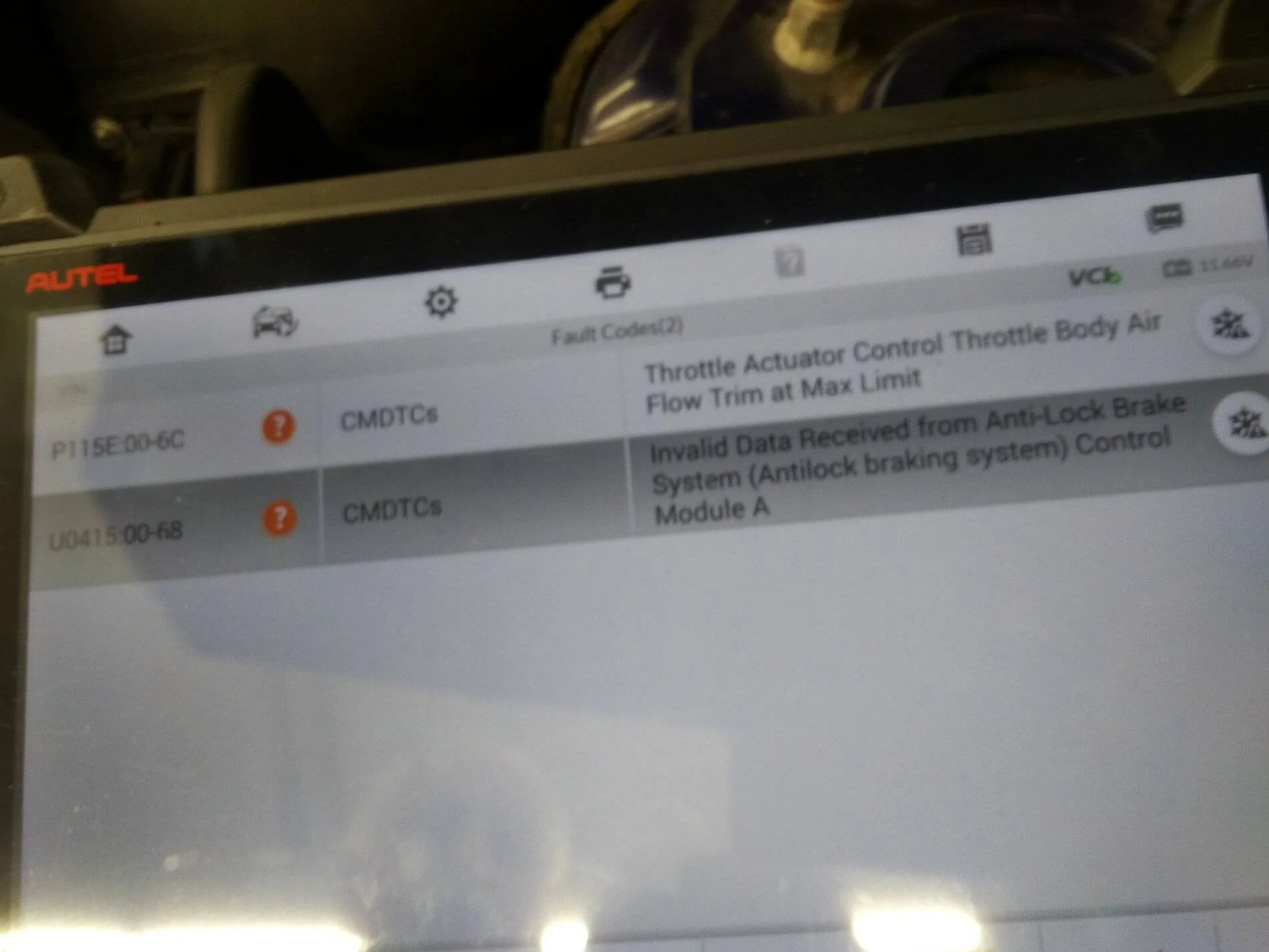

Disabled ABS, Traction Control, Hill Assist, and Service Advance Trac On

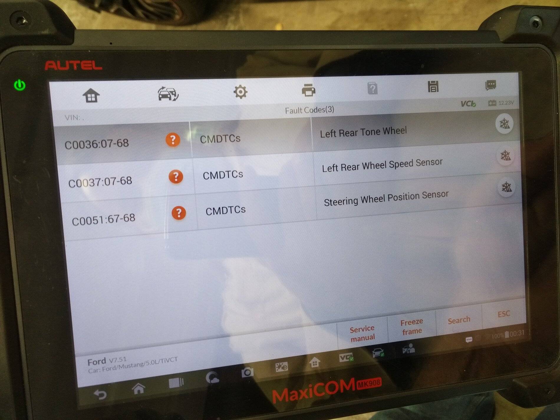

Dug into fault

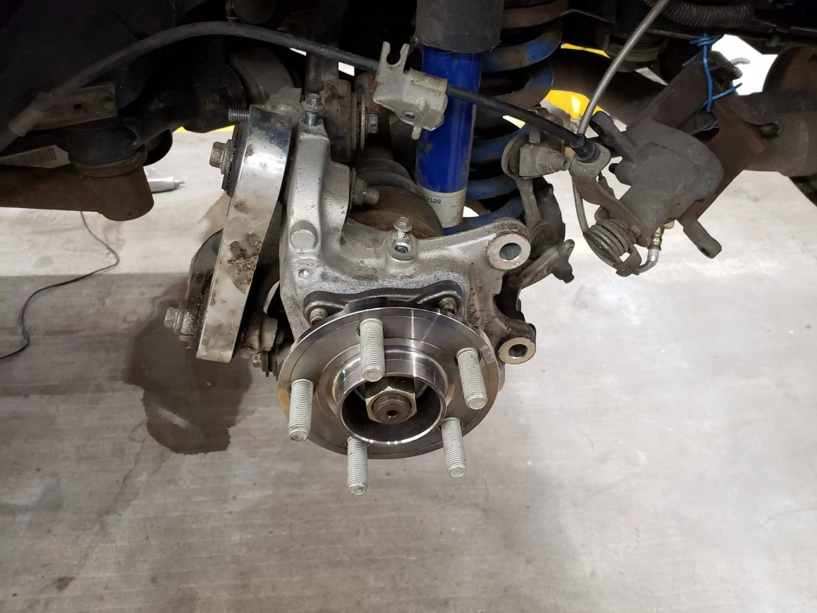

Took off tire and brake caliper. Removed sensor cleaned it and reinstalled. Found nothing out of the ordinary. After a short drive code popped back up so I'll order a sensor.

Also double check your wheel bearing .

The wheel speed sensor is on back/special order and a friend had a brand new wheel bearing so I bought it and put it on today. Wow, no nannies on the drive home from the hobby shop.
