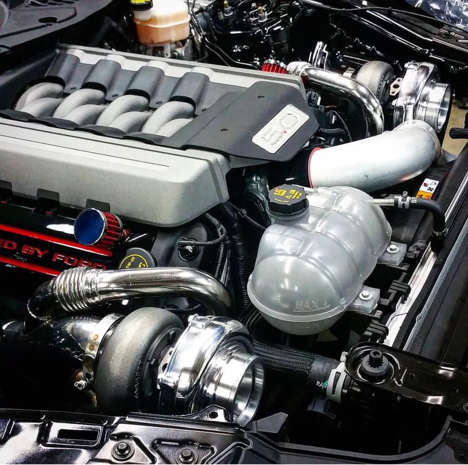

Like what you did with the regulator. Also that intake looks nice. Boss smoothed and painted?
Thanks! Yeah a gentlemen in GA that does awesome work with the boss manifolds.

Fist pull, 9psi and actually pulled to 7200ish this is justvon spring stay tuned as we turn on the controller and CO2:)

Wow! Thats a serious engine bay :eyebulge:

@NGOT8R look at the regulator under the manifold. Clean setup
