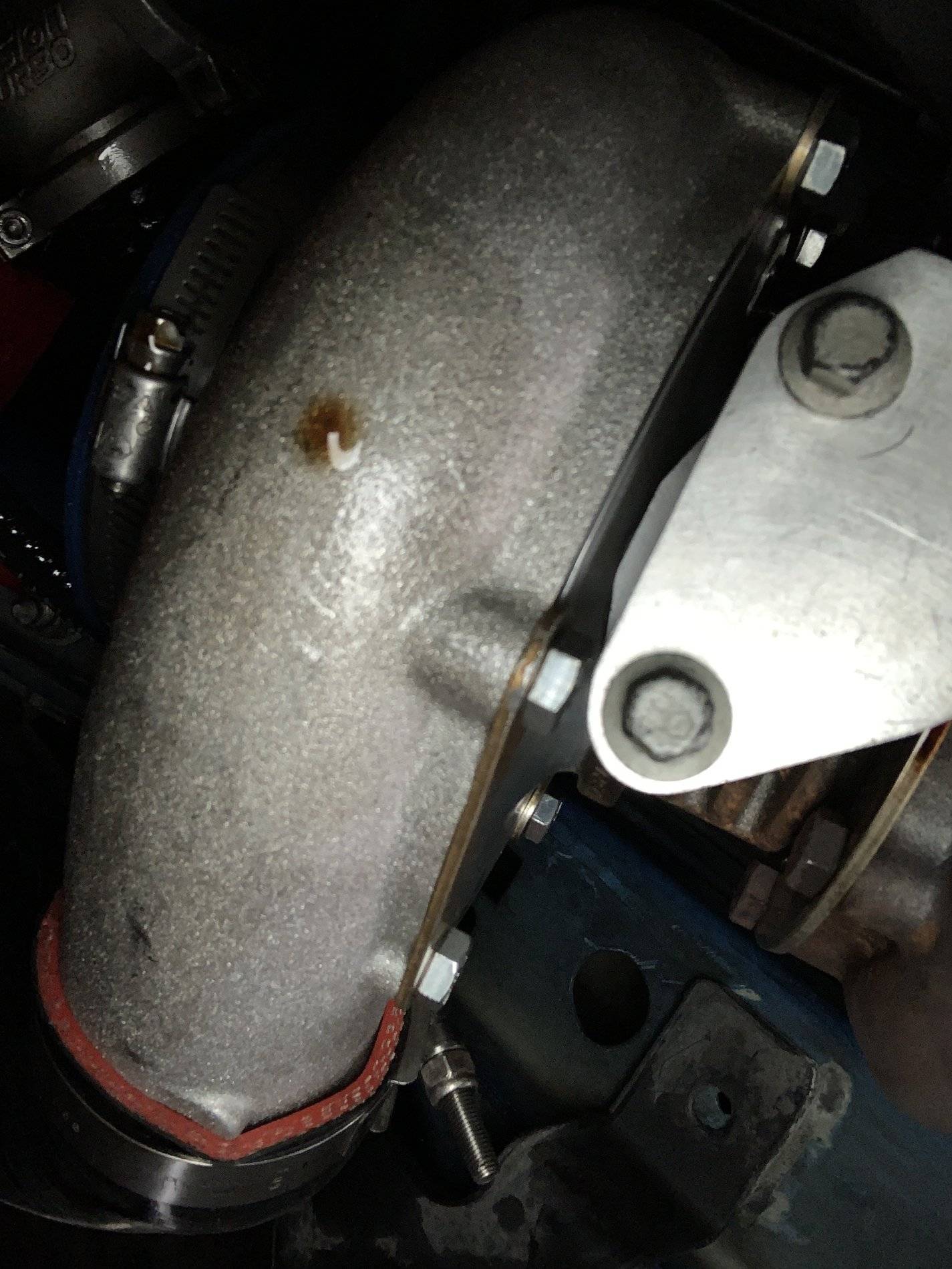

Hi guys, I have a bottom mount on3/custom turbo kit with Precision 6266 ball bearing turbos.
The turbos produce a bit of smoke on WOT and a little bit on startup. We've made sure the return lines aren't fighting gravity and we plan on adding some check valves off the turbos.
Any other ideas on what could be causing this? We aren't using a restrictor on the feed line (-10 AN) but I'm told that might be a place to start.

you definitely should be running restrictors on the feeds. And check valves on the feed and return. Also are you sure the feed is -10?

return should be a -10. Your feed should be -3 or -4. Returns are necessary Because bb turbos don’t require as much oil as journal turbos. The excess oil could be seeping past the turbo seals and contributing to your smoking issues

The issue is 100% the check valves and restrictors. You can get away with 1 right before the tee in the feed or 1 at each turbo really doesn't matter. As far as check valves one at each turbo won't work properly you need one after the pump in the return. Do both of those and I bet you won't be smoking anymore.

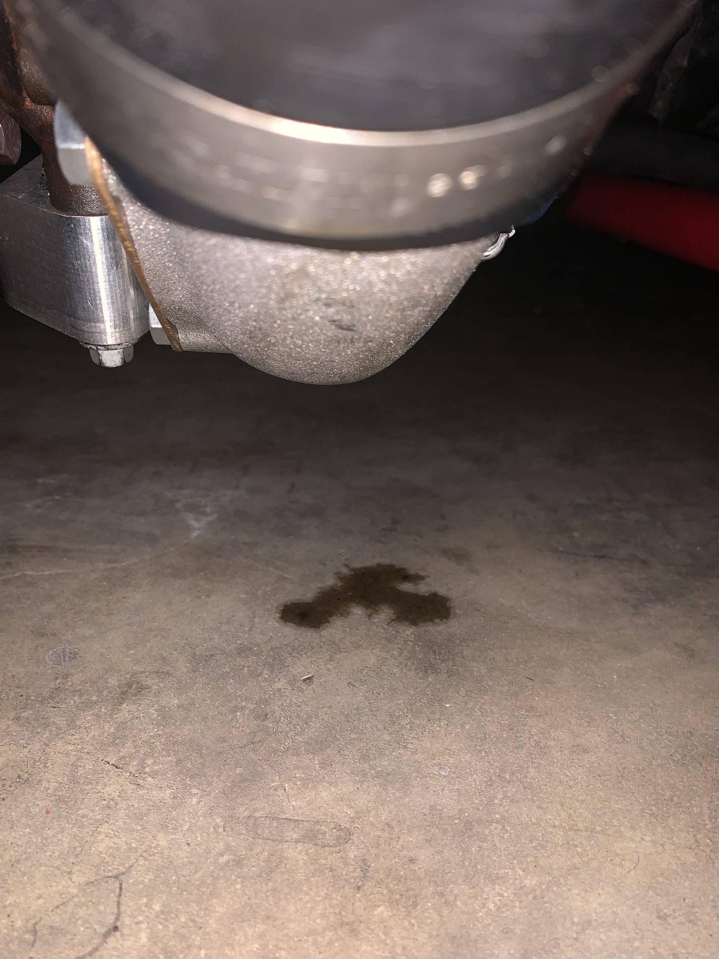

Forgot to mention that it seems that only the passenger side is the one smoking.

I bet if you pulled the actual turbos off both would have oil in them one is just holding in more. The oil is pooling and leaking through due to not have a check valve. You 100% need it with this system no way around it.
Precision will always tell you not to run a restrictor because if a turbo fails due to oil starvation the customer would blame them for saying not to use one. It's perfectly fine to run restrictors with no issue.

Check my build thread....lots of info on this topic.
This will solve your problem:
1 check vavle at the "T" of your turbo feeds.
1 check valve at the "out" of your scavenge pump.
Buy them here:
https://www.rbracing-rsr.com/oilsystems.htm
FWIW, my car has 0 smoking issues or leaking turbos. However, i had the exact same issues as you prior to my installing of the check valves and it was the passenger side turbo that was leaking for me too....
