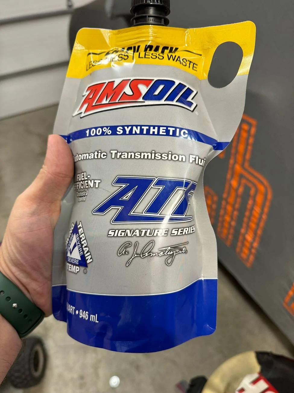

I changed mine after the first track season to (3000miles). Shifting smoothness improvement was noticeable. From new 2-3 shift wasn’t always smooth and the trans had a high frequency whine in 2nd. All of those things went away with the oil change. The oil performed as expected this track season. Will change it to fresh Amsoil in the spring.
