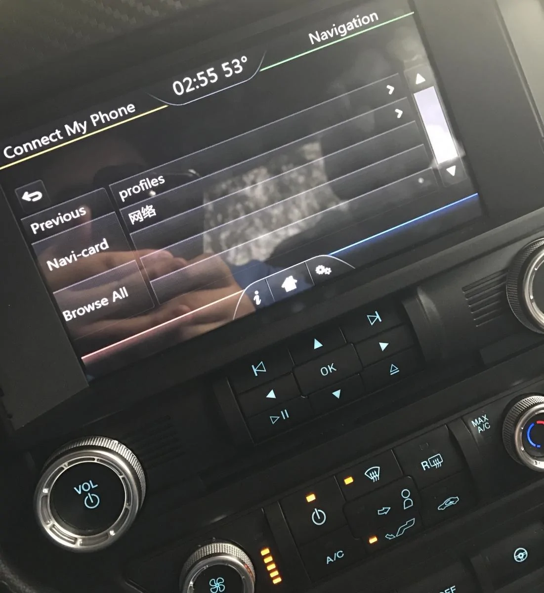

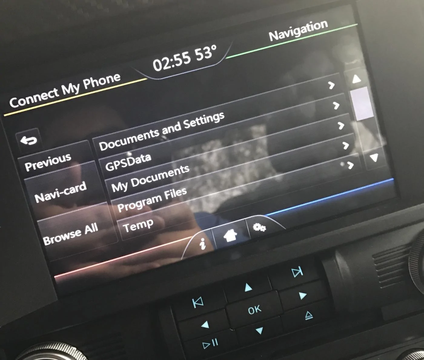

Ended up buying it from eBay. Yup. under the navi settings there is no storage card option. where storage card should be it says "temp", clicking on that bring some to an empty menu.

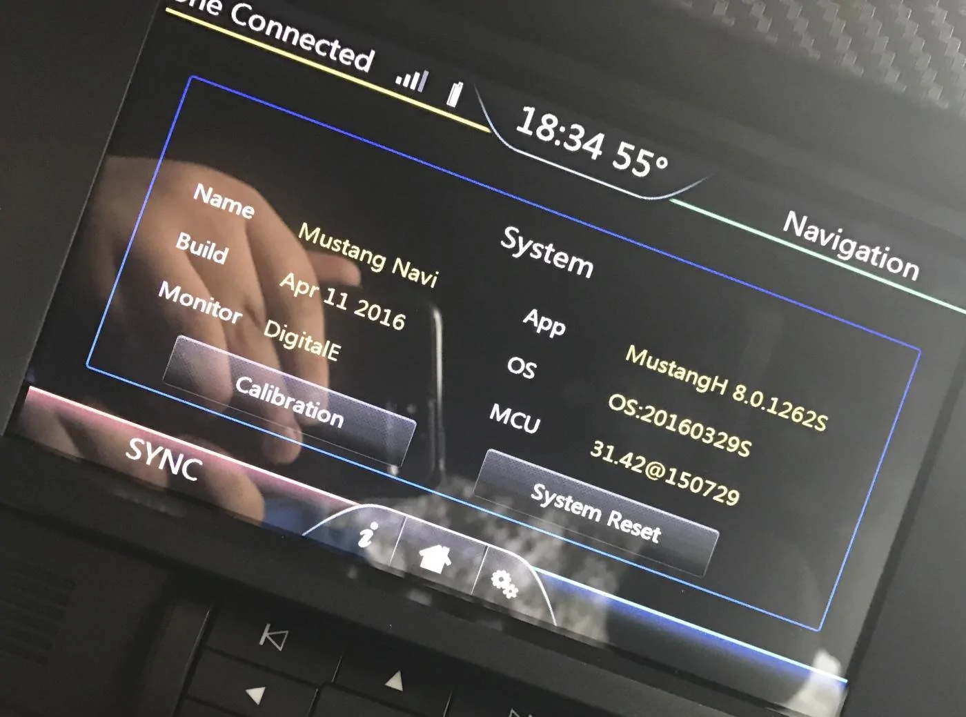

Thats my current OS and what I see in the Navi settings.
