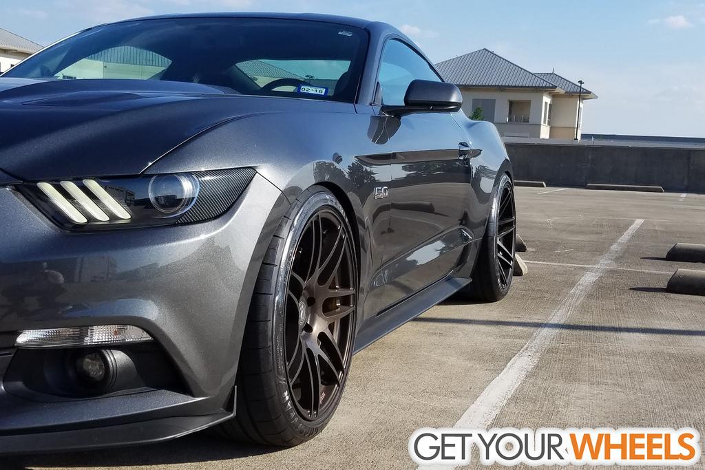

this guy did 275/35/20 in the rear with a 20x10.5 +30. You're definitely looking at some rubbing in the rear with a 305 tire unless you get some camber adjustments done... or you're stock height.
