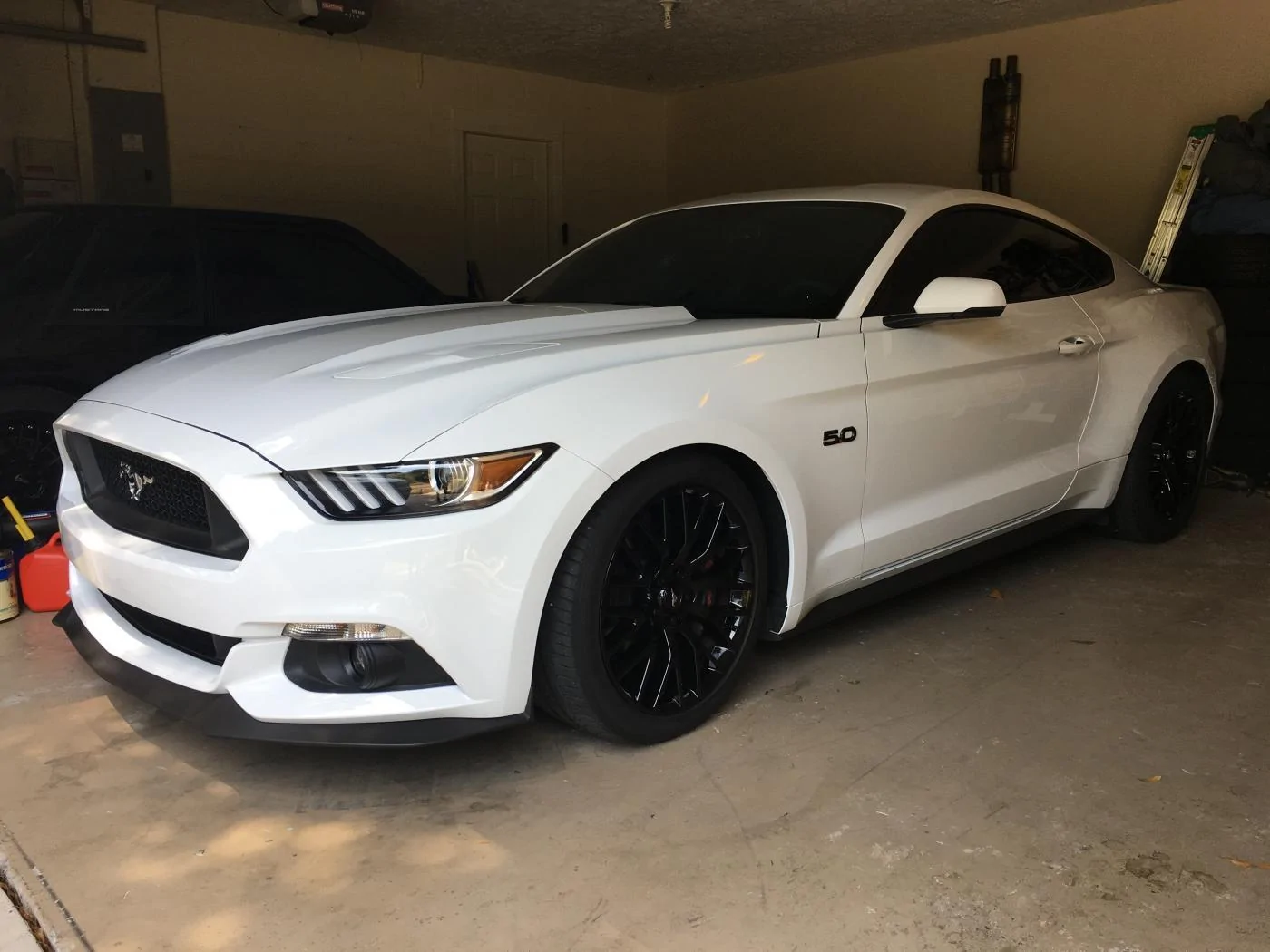

I am running very close to what you are asking. I'm 20x10 on the fronts with 285/35/20 tires and my rears are 20x11 with 315/35/20 tires. I'm lowered on an Eibach pro-kit and I don't rub anywhere. My rear offset is 50, and I think my fronts are 35. They're MRR M600's. The inside of my rears are just under a half an inch away from the rear shocks. The fronts are extremely close to the plastic piece of the front fender well when I turn.
