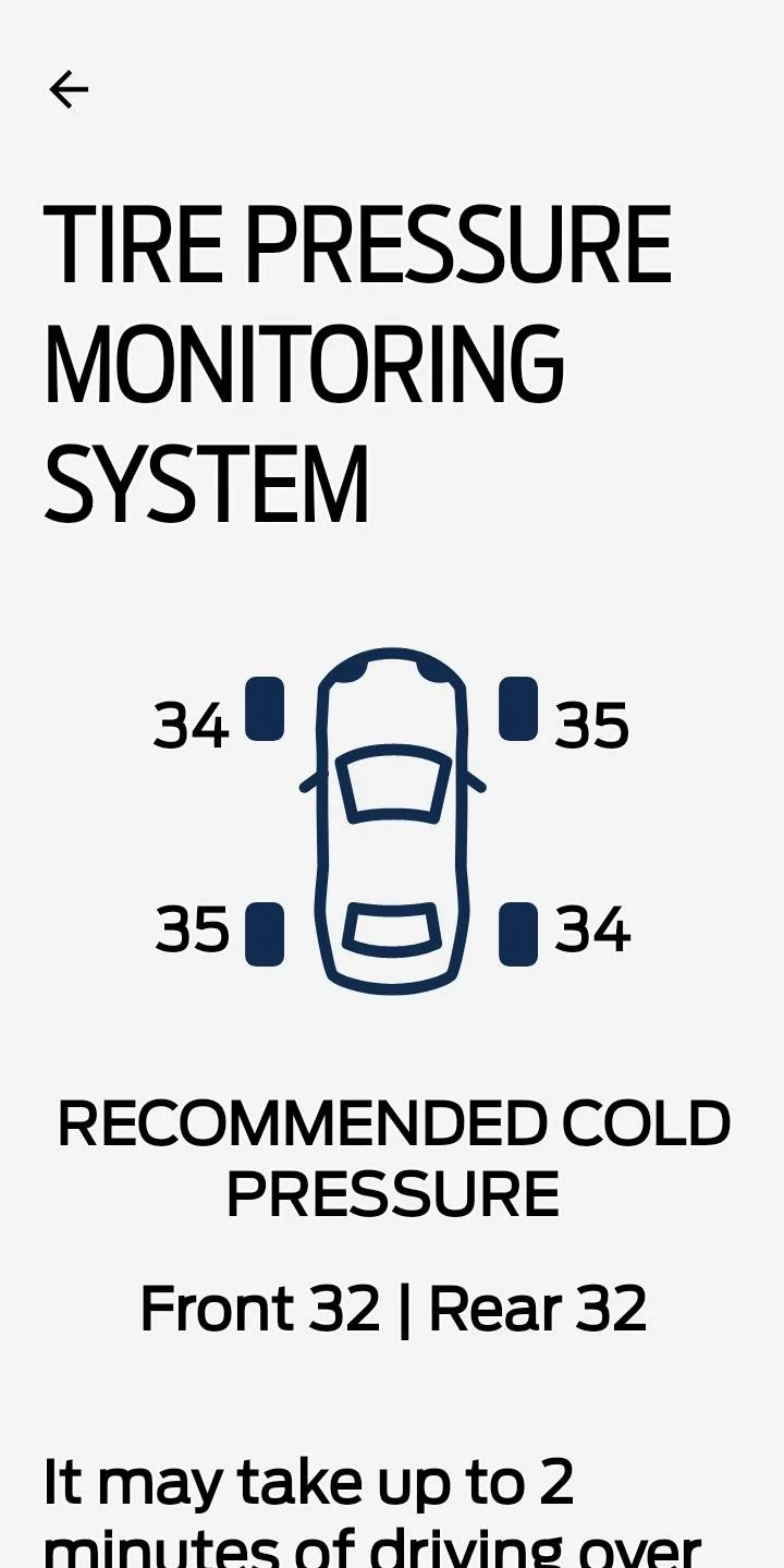

32psi cold is base line. My car typically runs at 38psi after warming up on the road. These pressures were all 38 when I parked the car. The first screenshot is a fresh update. Go with what the manual says to start at and unless you have a Cup Series pressure gauge, getting the pressures exactly the same is not easy. Well, for me anyway.
