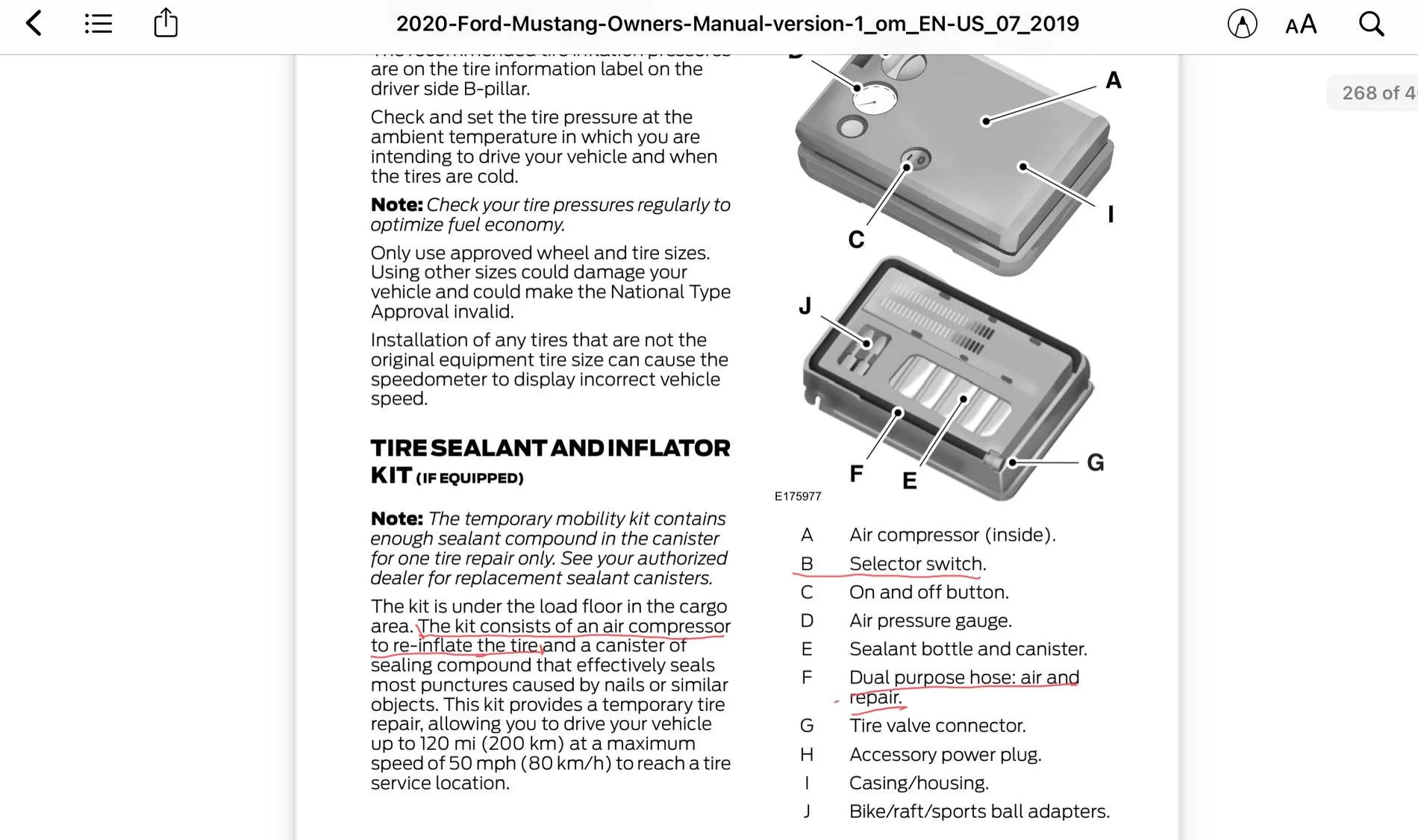

Hello guys. I never own cars without spare tire before. So I'm kind of new to Ford tire kit. I know that this is for fixing tire with puncture. My question is can I remove the sealant container and just use compressor to re-inflate low pressure tires?
You don’t have to remove the sealant canister. The compressor has a switch so you can select inflate and seal or just inflate
