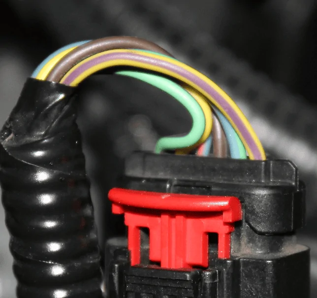

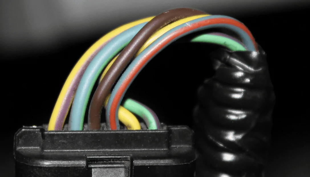

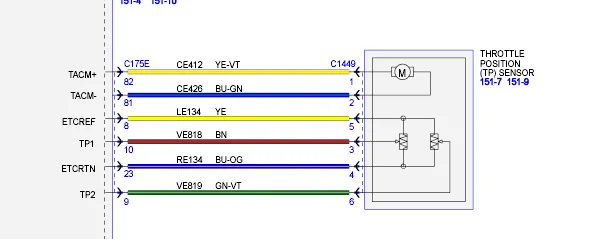

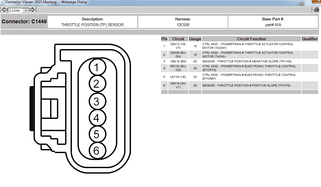

I removed my Roush setup; does anyone know the pin wiring order for the stock throttle body? I need to re-connect stock connector with the proper pin wiring order.
Thank you!

Will this work for you?
