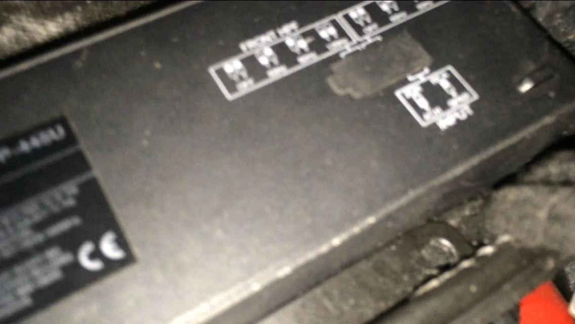

Well I have always done a full audio system on my cars for this one I'm using alpine's KTP-445U, JL's XD600/1v2, 10W3v3 & CleanSweep from my previous builds today I just did a little mocking of the Alpine amp I think I found its home. Tomorrow I will wire and secure it if I did find the spot. The CleanSweep will be the tricky one gotta find it a home. Speakers Ill most likely go with Focal. Sorry in advance if pics are upside down I'll try to fix them

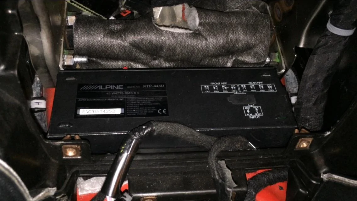

To kinda give an idea of the gap needed to make it fit you can't go all the up because of the connections for the radio and a/c can't go all the way down because of the USB and 12v Socket.

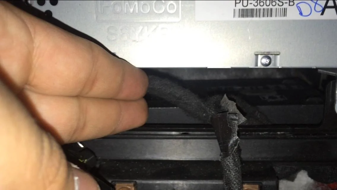

You might need to cut the Cloth wrap to make it fit right there's a mounting point that needs to be removed make the usb and 12v go on the bottom the other radio and a/c wires on top.

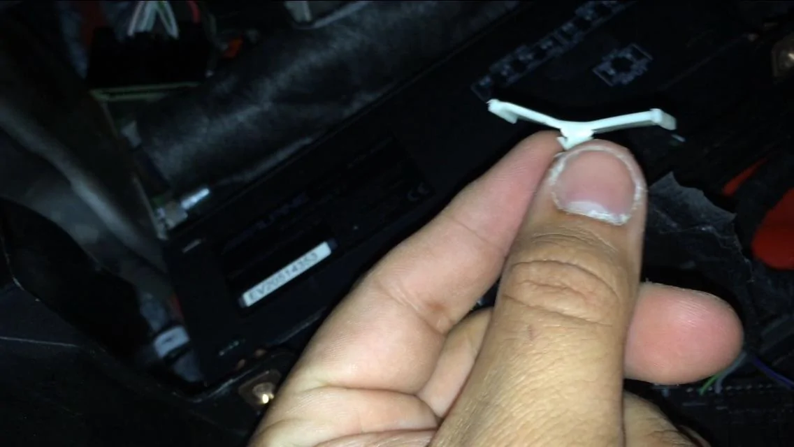

Here's the clip that needs to be removed from the mounting point to allow you to move the wires back towards the passengers side.

Wired up the amp speaker inputs and outputs. Connected the power wire for the sub amp.
