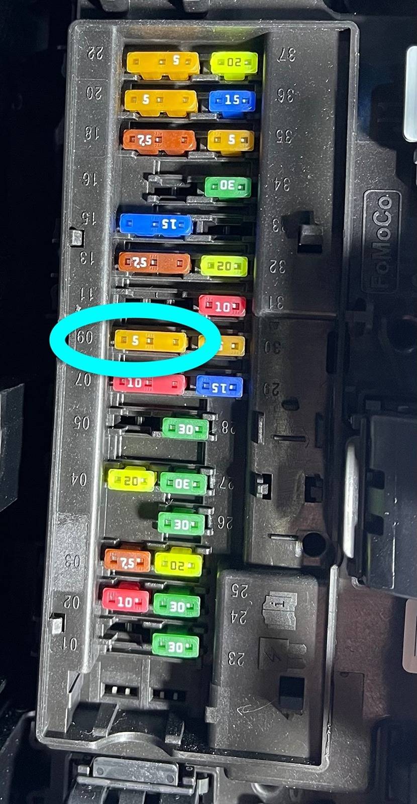

A vert might be a bit different, but check out the link above, the "Search" feature to the upper-right and the attached. I'd start in the trunk. There's also a fuse involved. If you'd like to turn the unit off, cut power to it, check out the fuse references in the Owner's Manual. There's a double fuse in the internal, cabin fuse panel that can simply be removed, while leaving cabling and modules in-tact.

It should be behind a panel found in the trunk, drivers side. So, I guess the unit is in the drivers side rear upper fender area, behind the trunk panel.

Should be right below the driver's side taillight on the inside of the trunk, you have to pull some carpet panels out of the way to see it.
