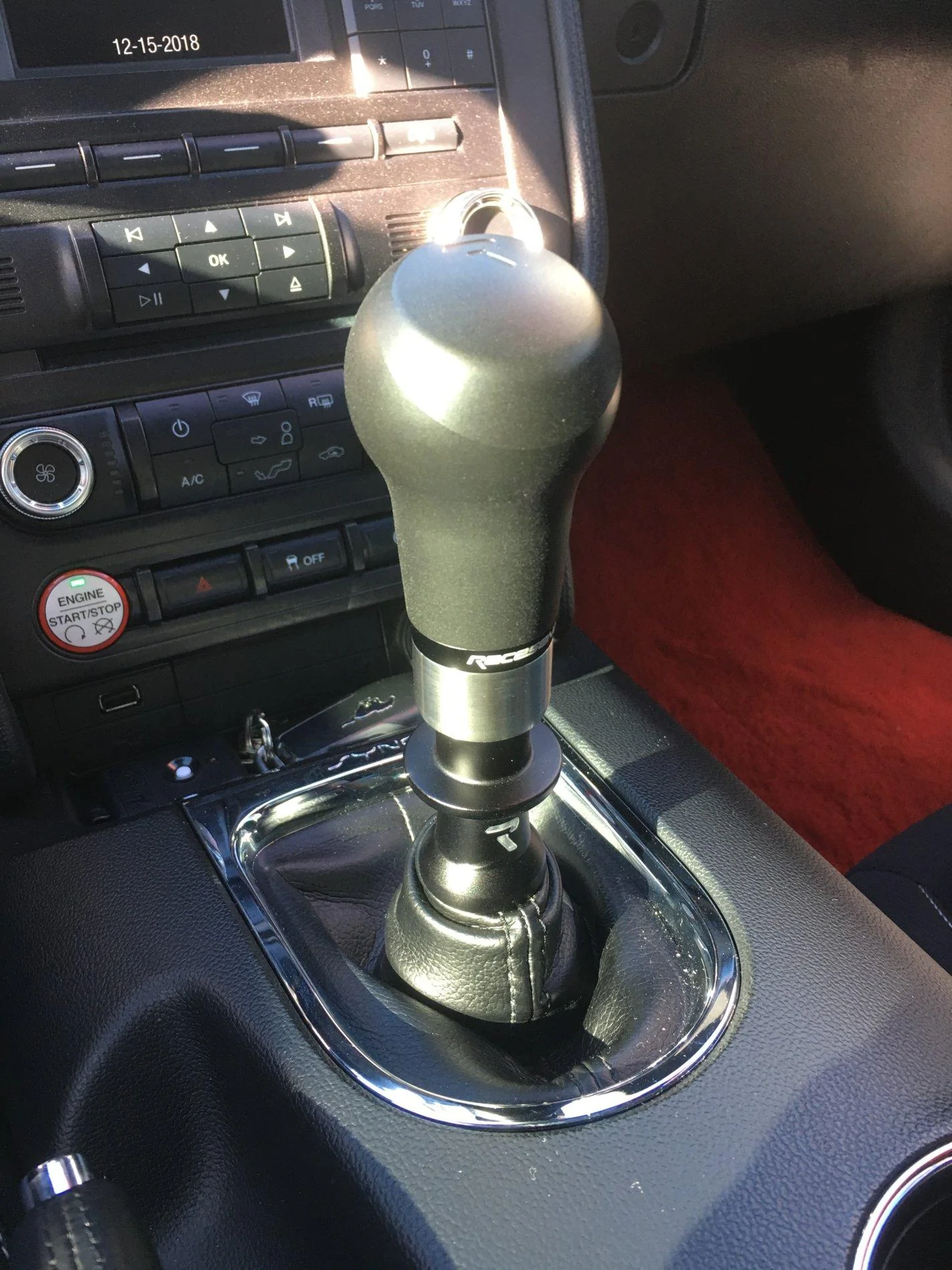

Check out raceseng shift knobs for a tall one attached is a picture of mine.

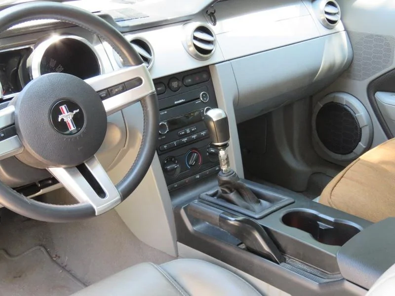

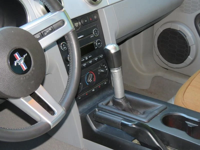

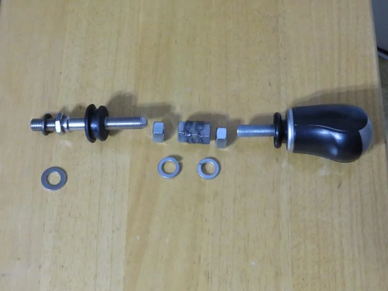

Make your own extension. Choose stud and nut threads to adapt any knob you want. You will want to insulate the entire length of otherwise-exposed metal bits.

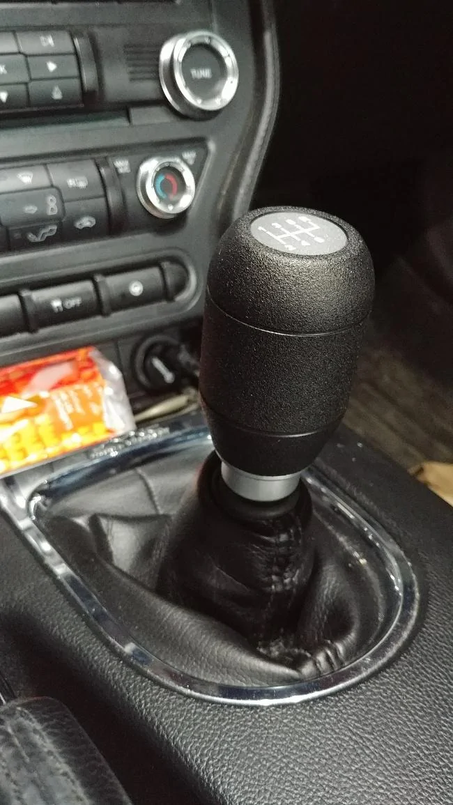

I added a nut under the shift knob about half way up the shift handle to give me some more height. I screw the gt350 handle down 6-8 full turns until it contacts the nut then give it some force to jam them together. Almost bought an extension like the one listed above but home depot provided a $0.25 solution.
