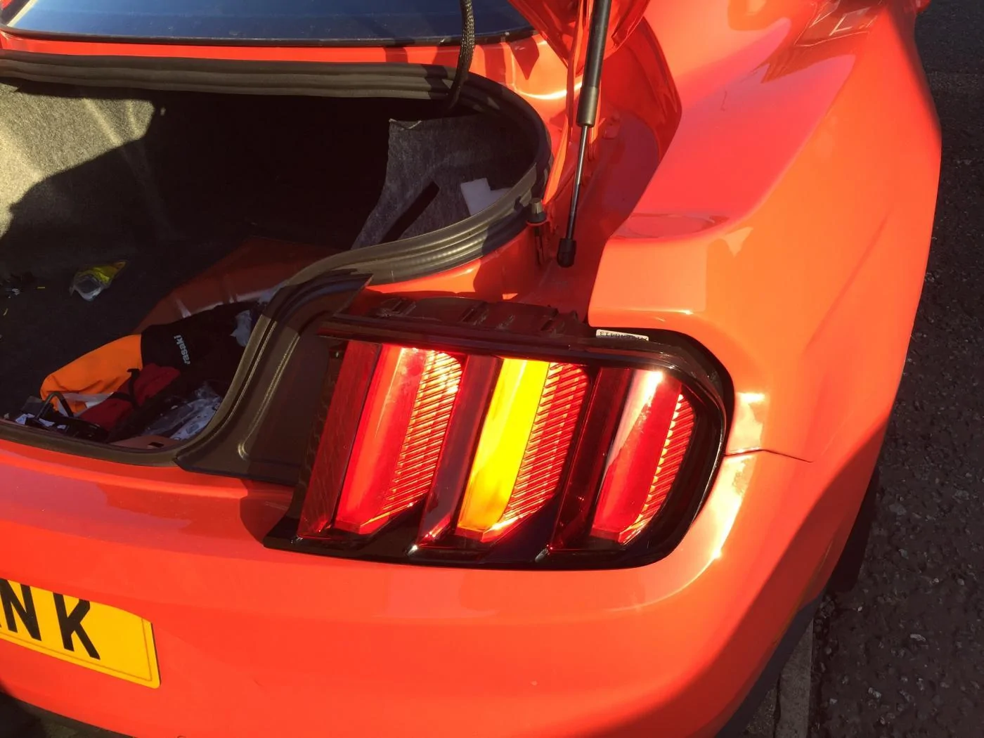

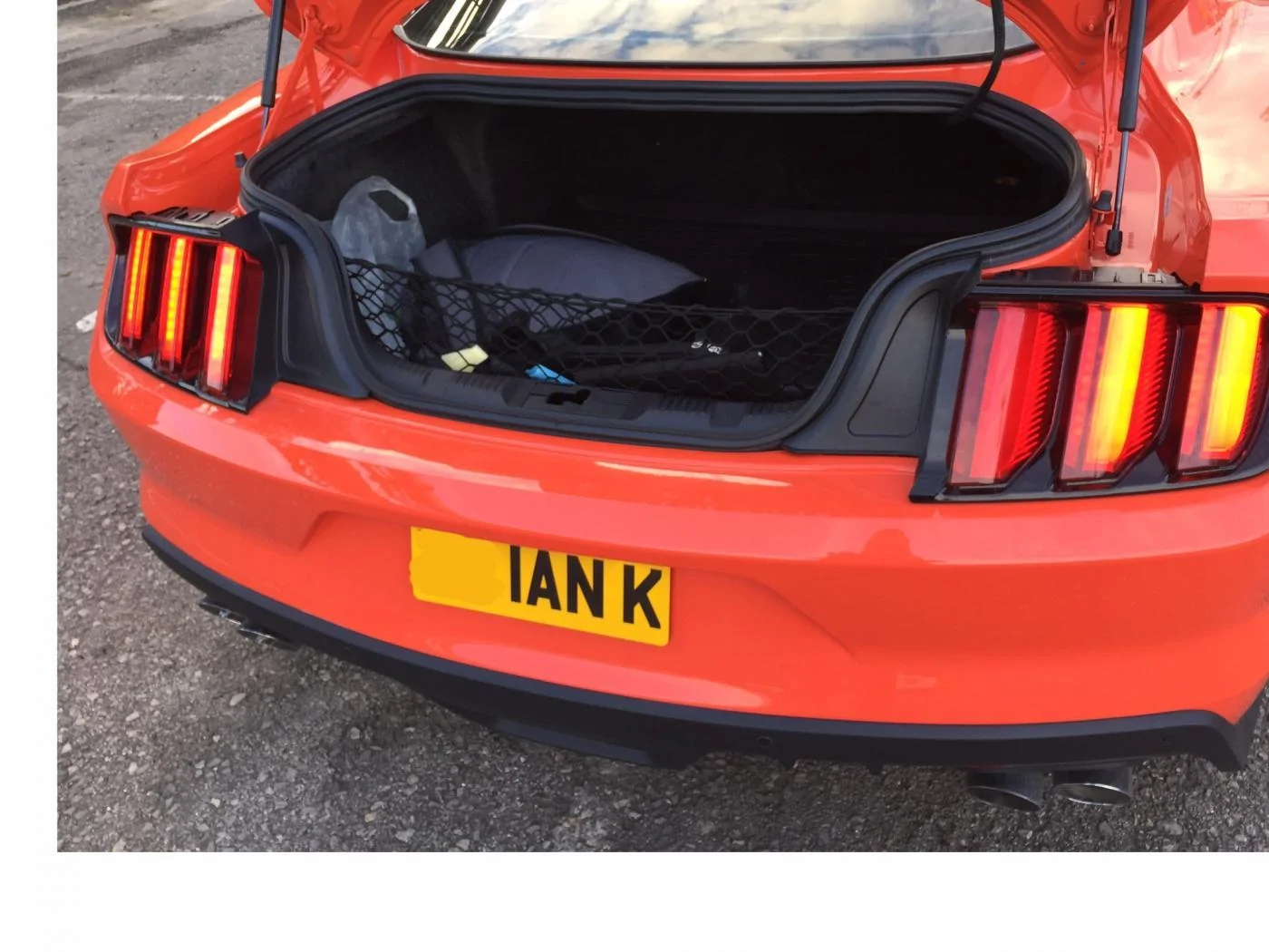

Another problem with my rears. Wish I never got them done done. Been back to Poland once for repair. Nothing but hassle. Gonna through them in the trash I think. And bought switchbacks aswel. They don't work. Never received a replacement
Glad I never got my fronts done
