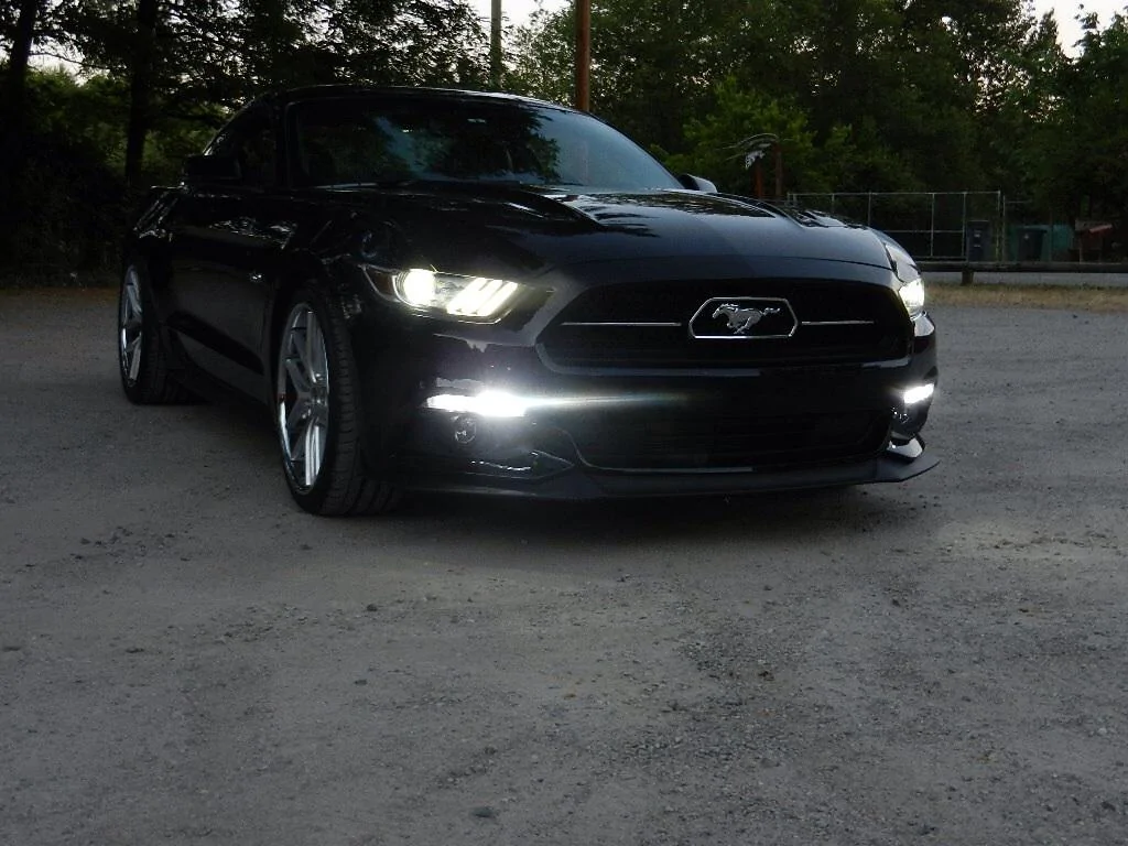

All you guys who installed them and not one picture lol! Post some pics up when you get a chance. Trying to figure out how off the cool white LED is when compared to the pure white DRL's.
Cool whites...installed the fogs as well but no pics!! In Mexico til March!!

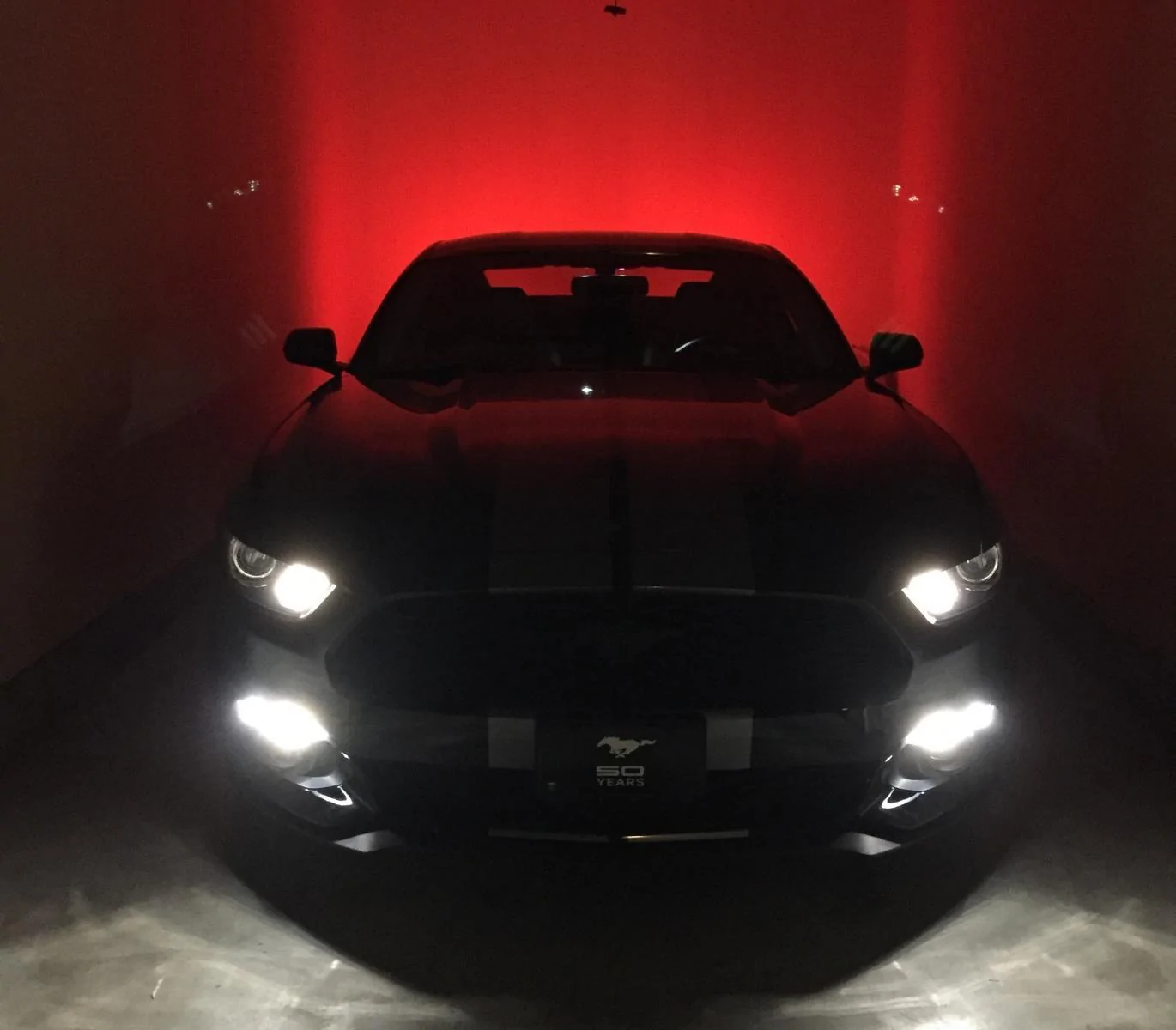

Here's mine. It took me a while to replace the front left side marker but its all worth it. :thumbsup:
