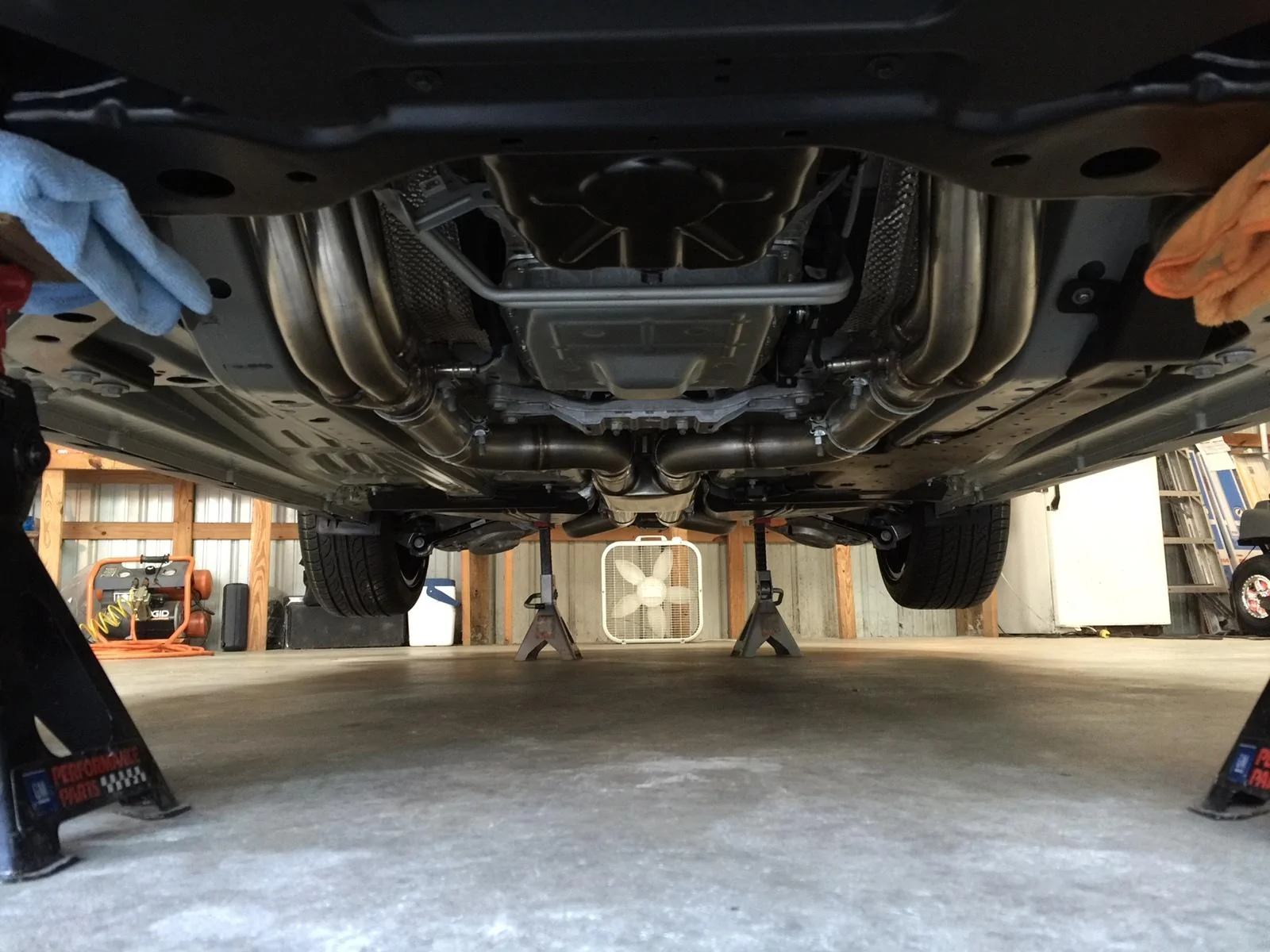

Does anyone one make the correct extensions or complete lead replacement pipes? I really do not want to go to an exhaust shop and have any of my current pipes hacked up or welded up. I want to be able to unbolt if need be at any time. Right now I have 6 inch extensions with 3 OD to 3 ID pipes connecting the leads to the catback and they don't exactly connect very well. Thanks for any help.

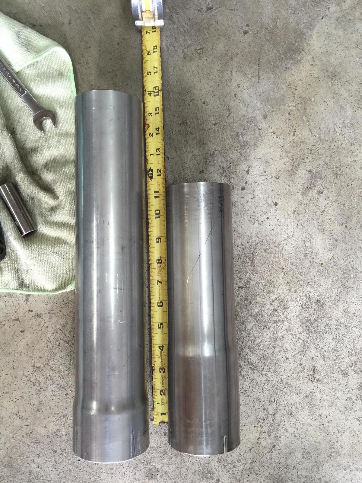

Or you can go to Orielly's and purchase two sections of 3" stainless pipe for $9 each and cut them to size. One end is already flared for a slip fit, all you'll need is another pair of clamps.
