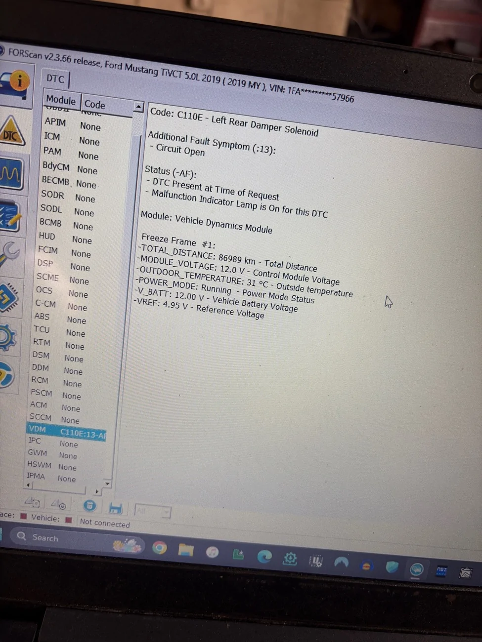

Code C110E-13 after dropping subframe and replacing differential bushings

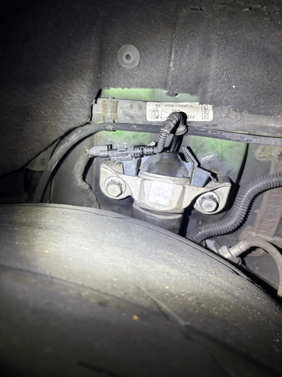

EDIT: I know it’s disconnected in the pic but the DTC remains even when connected and returns immediately
Replaced the rear diff bushings with kelltrac ones, have noticed more stability during speed bumps and turns are a lot sharper and quicker. Can’t currently test more due to vehicle being limited with this new code that came up, did all sorts of checking and have not found anything wrong with the connector to it, thoughts? We did a continuity test on the connector (shock side) and it wasn’t ringing on the multimeter, then we went to the right one and it was ringing, no physical damage found anywhere
