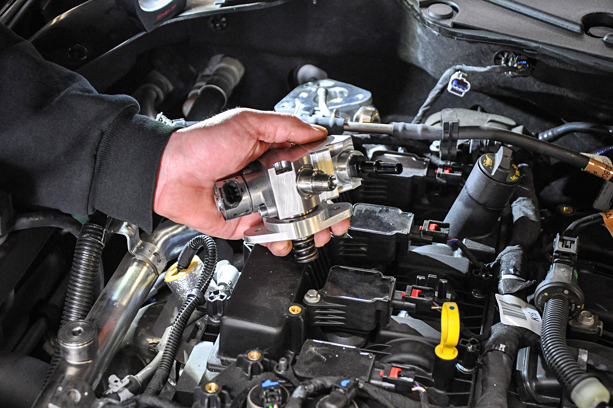

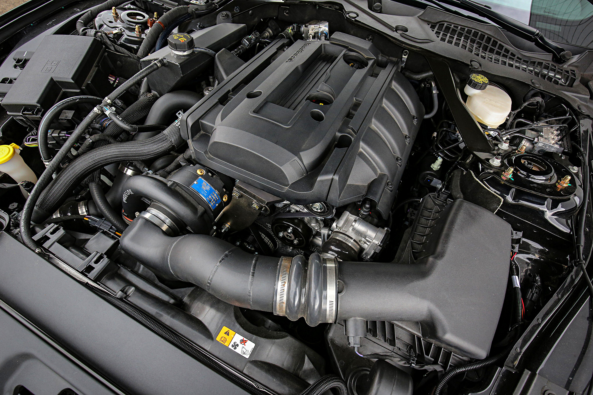

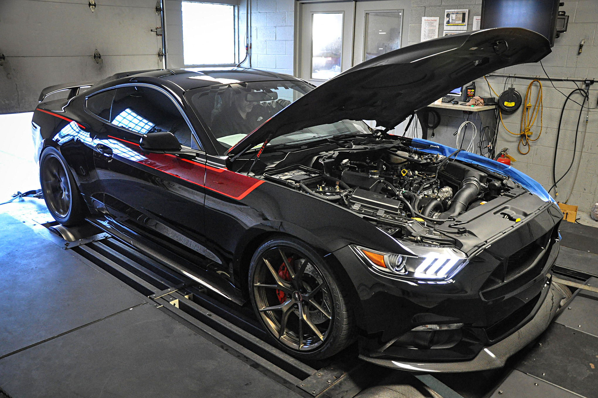

A client of our's Mustang Race Technologies (MRT) has actually built a pretty slick double-blown 2.3L Mustang with a Vortech V3 centrifugal supercharger. We were fortunate to be a part of this one off custom build and helped out with some extra fueling via our Firestorm high pressure fuel pump upgrade. Once the new pump was installed we also provided our custom dyno tuning services to take this build to a whole new level.
"The 2.3L EcoBoost has proven to be a robust little piece, but its factory fuel pump is a definite roadblock on the path to more power. Tasked with supplying direct-injection demands at somewhere around 3,000 psi, the OEM pump simply runs out of volume anywhere beyond factory boost levels. Luckily, Livernois Motorsports’ new “Firestorm” EcoBoost replacement pump is said to be capable of double the factory fuel volumes, and came along just in time to support the Sport Touring project’s compound boost.
Even so, given the touring – as opposed to racing – focus of the project, MRT’s plan called for keeping stock EcoBoost engine internals and fuel injectors. This meant keeping boost levels reasonable, and presented a delicate tuning task for Livernois’ Dan Millen, with the goal being great drivability and more area under the power curve, rather than gonzo peak power numbers."

This is sweet, but why not go with a 2.0 block if you're going to spend all the money to get you to the same place that a big turbo kit can? The limits of the block are still there twin charged or not.
