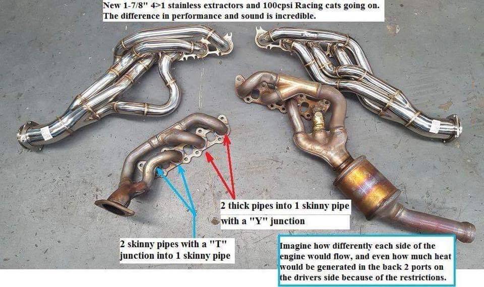

Yours a RHD s550? Haha I know the US guys are ok but our RHD ones are very badly designed as per example pic attached.
I also tend to overthink ‍♂

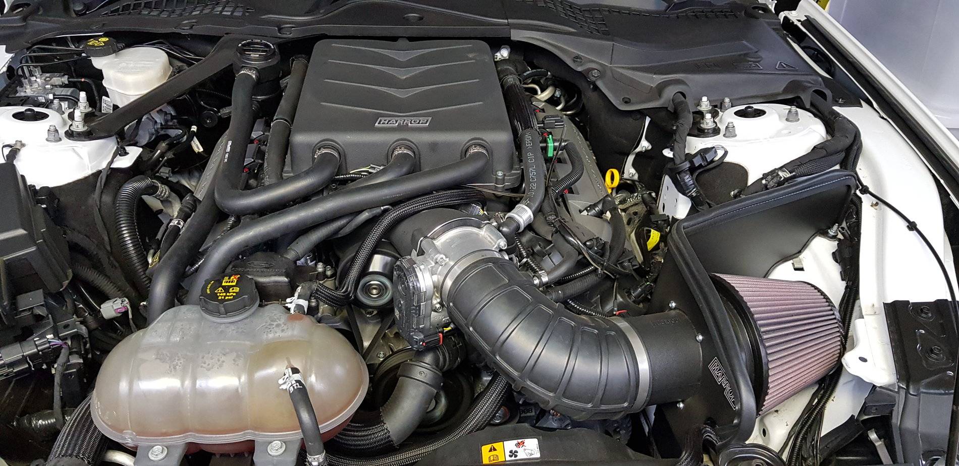

470 kw and 675nm torque on Harrops hub dyno. Lots of room for improvement with more aggressive tune

Despite the even poorer flow of our RHD headers, the actual gains from a set of longtubes on a blown car don’t seem to be all that great at the power levels you’ll achieve on PULP.
I went longtubes prior to adding the blower (which DOES give a fair gain) and then went catless once the boost was added for the simple reason that cat failure isn’t unheard of and the results aren’t always as simple as replacing the cats (think potential engine damage instead).
Personally, I wouldn’t add a blower to a RHD car on stock headers/cats but it’s your call.
As long as you’re aware of the risks you can make your own assessment.
What you also need to remember is that once you remove the cats you no longer need cat protection in the tune, meaning you aren’t losing power as the tune dumps extra fuel to cool the cats down. Some tuners may turn this function off regardless of whether cats are installed or not. Again, be aware.

Cheers Burkey, well said. I ended up making about 440kw on the hub dyno (with bonnet open I assume) so it’s realistically making about mid-high 300rwkw id say which I’m happy with, as long as the stock headers won’t lead to issues I’m happy to leave them (especially since I’m not after it to be any louder than it already is) - The OPG on the other hand is something I plan to address since they are known to fail with hard driving, but if stock RHD headers aren’t known to cause dramas I may leave them.
