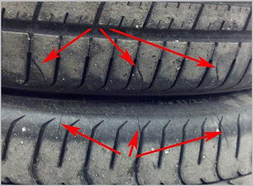

I found a service bulletin that says to store the summer tires above 20 degrees. Attached is a photo of the kind of cracks that can develop. Kind of a PIA to deal with, but the right tires for the right conditions do make a car feel planted to the road.

I can not believe Ford has not recalled these Pirelli P-zero tires. This whole tire cracking issue could turn into the Firestone debacle of 1999-2002. The average consumer has no idea of the safety concern these tires can cause. To the average Joe, tires are tires, round with tread on them. Hell, they wouldn't even know if their tires were low or flat if cars didn't have standard tire pressure monitoring systems. :rant:
