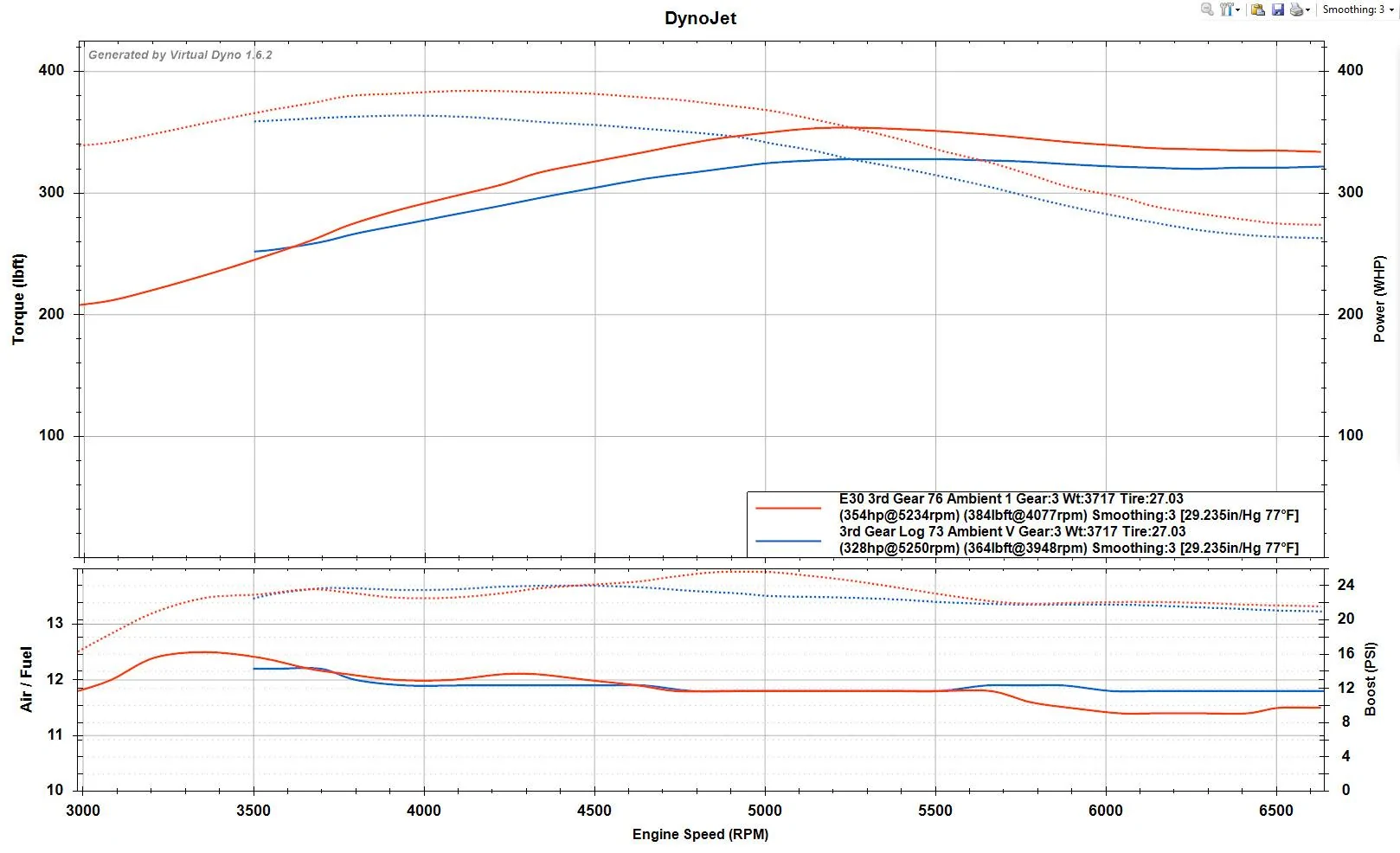

Here’s the before and after VD graphs for comparison, both 3rd Gear and same stretch of road with similar ambient temps, same quality of fuel, and proper mixture on e30.
***Edit*** The VD graph below is from revision number 4. Now after driving on revision 5, it feels like we picked up another 10whp between 4500-5500rpm. I haven't data logged the final revision, as soon as I do I will add it to this post.

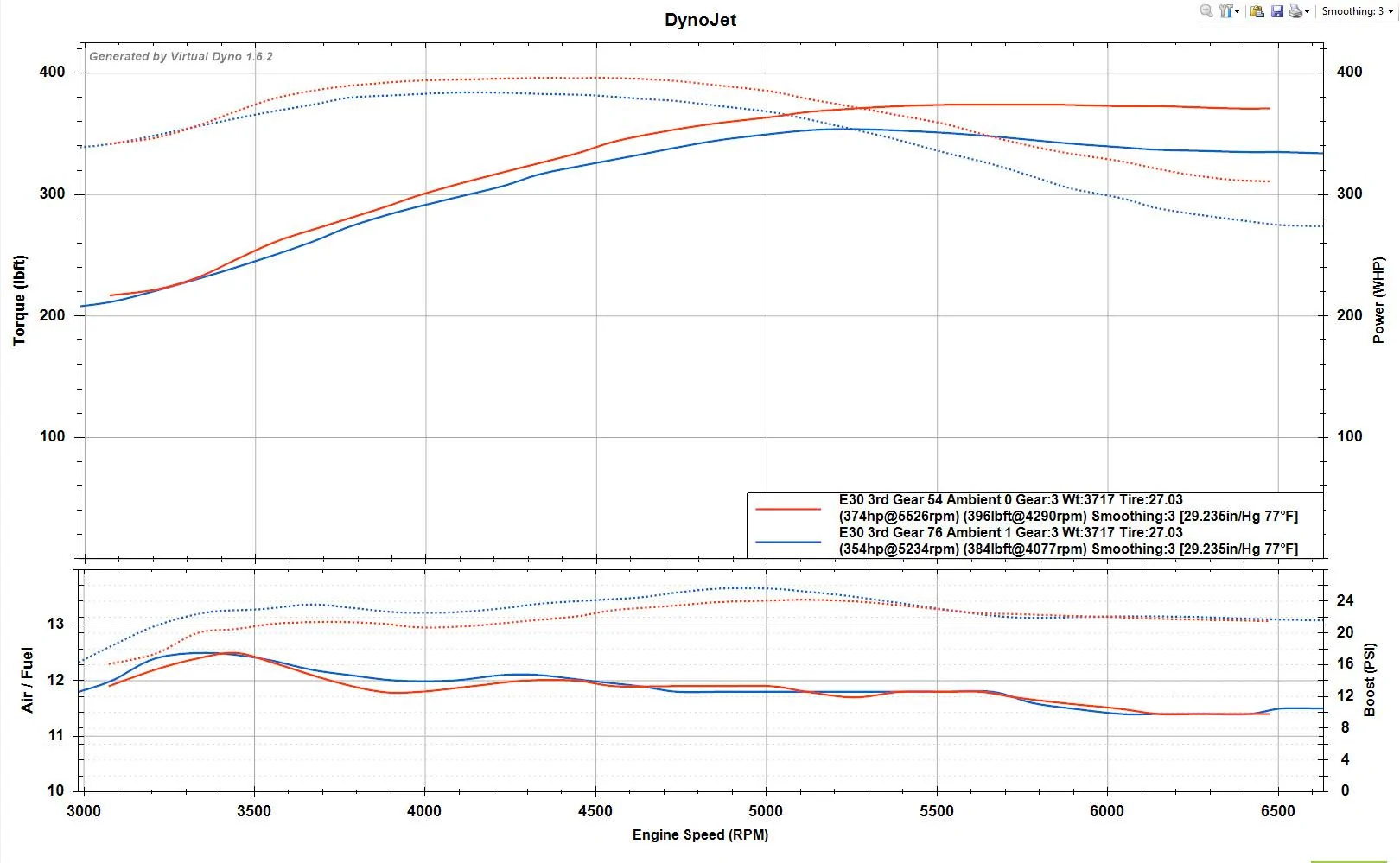

***Edit*** Edit*** Please see the added VD graph showing the difference between the 4th revision and the 5th. First thing to note is that ambient temps were 20 degrees cooler on version 2.5, which usually results in a difference of about 1hp for every 1 degree in difference in charge air temps, so no real peak gains, however power drop off up top is less and it's making it on less boost. Again, probably mostly temperature related, but it does pull better all the way through. Thanks again for the tune Alex!
